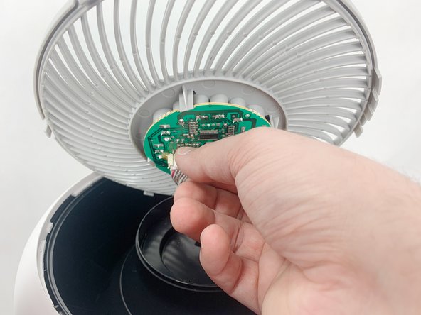

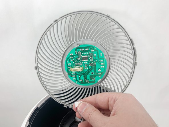

      • Insert the Jimmy between the gray grille cover and the top of the device.
      • Work your way around the grille cover with the Jimmy to release the clips holding it in place.
      • Take note of the placement of the tabs, as they are keyed and need to go back in the exact way they came out.
      • Remove the grille cover gently as it is connected by a ribbon cable.
      • Be careful not to put too much strain on the ribbon cable as it may break.
    9. Levoit Core 300-RAC Fan Replacement: crwdns2935265:012crwdnd2935265:01crwdnd2935265:03crwdne2935265:0 Levoit Core 300-RAC Fan Replacement: crwdns2935265:012crwdnd2935265:02crwdnd2935265:03crwdne2935265:0 Levoit Core 300-RAC Fan Replacement: crwdns2935265:012crwdnd2935265:03crwdnd2935265:03crwdne2935265:0
      • Squeeze the tab on the connector to release the bundled cable from the control board.
      • The connector should come out fairly easily, do not force it. Pulling too hard could damage the connector.

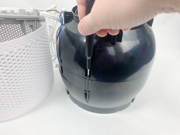

      • Use a Phillips #2 screwdriver to remove the three screws on the upper portion of the black housing.
      • Set the screws aside in a safe place.
    13. Levoit Core 300-RAC Fan Replacement: crwdns2935265:016crwdnd2935265:01crwdnd2935265:03crwdne2935265:0 Levoit Core 300-RAC Fan Replacement: crwdns2935265:016crwdnd2935265:02crwdnd2935265:03crwdne2935265:0 Levoit Core 300-RAC Fan Replacement: crwdns2935265:016crwdnd2935265:03crwdnd2935265:03crwdne2935265:0
      • Remove the upper portion of the black housing.
