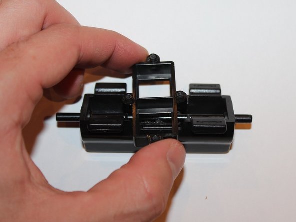

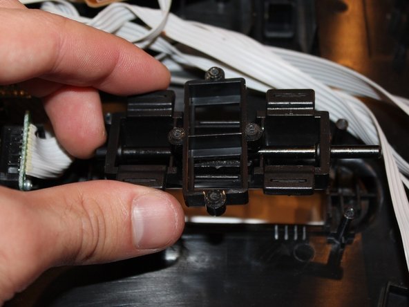

    • Remove the 4 screws from the back of the strum chip using a Phillips PH1 screwdriver. each of these screws are 1.2 cm each.
    • Remove the 4 inner screws, each are 0.8 cm.
    • Make sure that when putting back together, the 4 inner screws line up with the small plastic piece underneath.

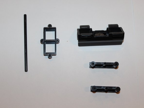

    • Remove the two plastic holders on the underside of the chip.
    • Pull out the the plastic piece on each side of the strummer.
    • Lift the strummer out of it's location

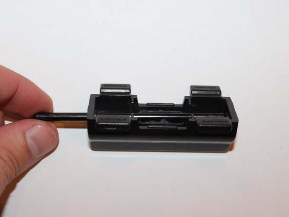

    • Take the top black cover off the strummer.
    • Slide the black rod out of the side.
    • Clean if needed.
