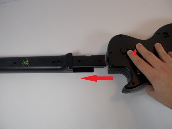

    • Unscrew the 11 screws securing the back of the body using a T10 Torx screwdriver. Each screw is 1 cm long.
    • Push level, this will detach the back of the guitar from the front.
    • Carefully remove the back of the body
    • The battery pack cord is attached to both sides of the guitar, be careful not to tear it apart.
    • The neck connector may be stuck to the back so be sure to detach it before fully pulling

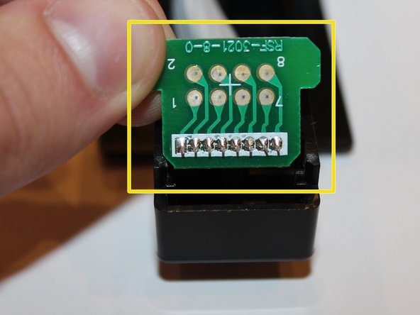

    • First check to see if the button motherboard is not damaged.
    • Next, make sure the wire is not damaged.
    • Then make sure that the connection motherboard is also not damaged.
    • If any of these parts are damaged, then it will need to be replaced.
  6. Les Paul Wireless Guitar Peripheral Neck Connection Replacement: crwdns2935265:06crwdnd2935265:01crwdnd2935265:01crwdne2935265:0
    • Check to see if the neck connection chip is not damaged inside of the guitar.
    • Make sure that all 8 prongs of the chip are not damaged or broken.
    • If the neck chip is damaged then it will need to be replaced.

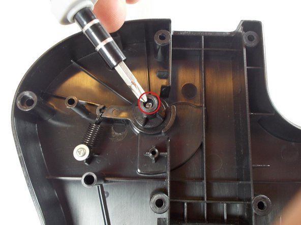

    • The lock mechanism may be another reason for trouble in your neck connection.
    • Use the guitar tear down to open the guitar to this point.
    • Start by unscrewing the two screws holding down the main connection parts. The first screw is 1 cm and the second screw is 0.8 cm.
  8. Les Paul Wireless Guitar Peripheral Neck Connection Replacement: crwdns2935265:08crwdnd2935265:01crwdnd2935265:01crwdne2935265:0
    • Take the spring off the main connection mechanism. It should come off pretty easily.
    • If this spring is broken or snapped, then it will need to be replaced.
  9. Les Paul Wireless Guitar Peripheral Neck Connection Replacement: crwdns2935265:09crwdnd2935265:01crwdnd2935265:02crwdne2935265:0 Les Paul Wireless Guitar Peripheral Neck Connection Replacement: crwdns2935265:09crwdnd2935265:02crwdnd2935265:02crwdne2935265:0
    • Pull out the main connection mechanism.
    • Make sure that it is not broken or it will need to be replaced.
    • This can be put back together by inserting the mechanism again, attaching the spring and screwing the two screws back in place.
