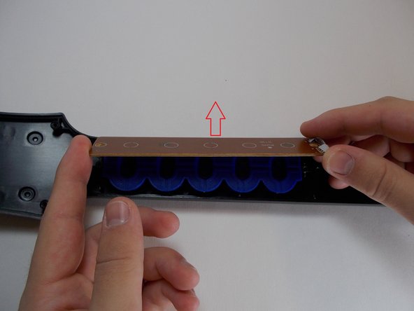

  3. Les Paul Wireless Guitar Peripheral Fret Buttons Replacement: crwdns2935265:03crwdnd2935265:01crwdnd2935265:02crwdne2935265:0 Les Paul Wireless Guitar Peripheral Fret Buttons Replacement: crwdns2935265:03crwdnd2935265:02crwdnd2935265:02crwdne2935265:0
    • Unscrew the two screws on the fret PCB using a PH1 Phillips head screwdriver. Each screw is 0.8 cm.
    • Remove the fret PCB
    • The fret PCB is in very tight. Be careful not to break it.
    • The connector from the neck to the body can easily slide out of place. Make sure it is in position before closing the neck
