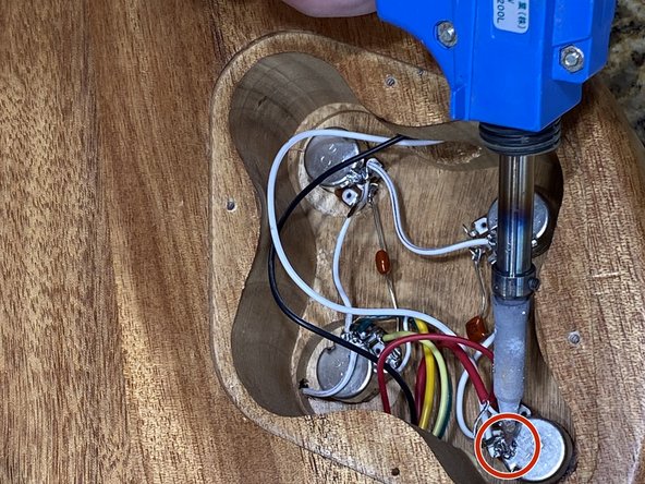

    • Note which color wire is coming out of each pickup.
    • Gently flip over your guitar and put it on a soft towel or other soft material. Take off the control cavity cover.
    • Desolder the wires of the pickup from the terminal that is touching the back of the potentiometer, or pot.
    • A potentiometer is what the pickups are wired to that allow the player to have on-board control of their volume and tone. Terminals are the parts on a potentiometer that you solder the wires to.

    • Do not touch the soldering iron, or let it touch anything but the solder and wires.
    • The pickup wire should have multiple wires inside it. Check with the manufacturer which wire is which.
    • Solder the new ground wires to the back of the volume pots or to the terminal touching the back of the pot.
  6. Les Paul Guitar Pickup Replacement: crwdns2935265:06crwdnd2935265:01crwdnd2935265:01crwdne2935265:0
    • Do not touch the metal parts of the soldering iron or the solder after melting it, they will burn you.
    • Relative to the output jack, the bottom row is for the bridge pickup and the top row is for the neck pickup.
    • Identify your hot wires and volume pots and solder the hot wire to the center terminal of the wires corresponding pot.

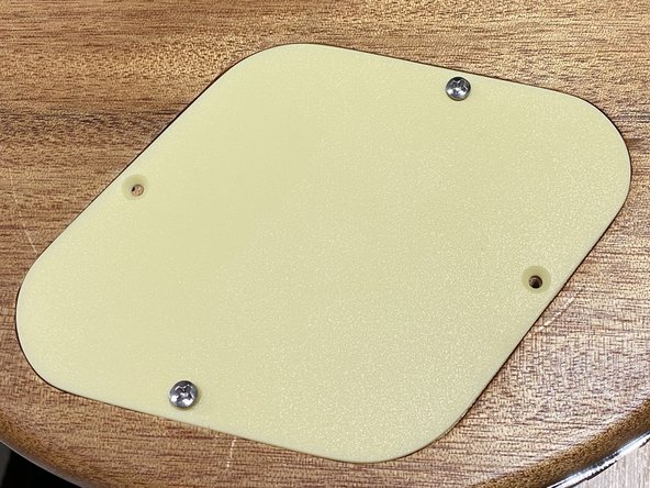

    • Screw back on the control cavity cover and flip over your guitar.
    • Reattach the tailpiece and tune your guitar.
    • Raise and lower the pickups as desired using the two screws on the sides of the pickup rings.
