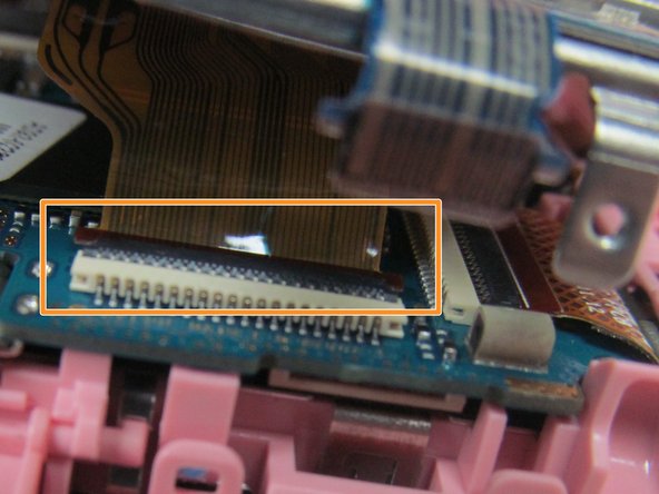

  3. Lens Replacement, Removing the Ribbon: crwdns2935265:03crwdnd2935265:01crwdnd2935265:02crwdne2935265:0 Lens Replacement, Removing the Ribbon: crwdns2935265:03crwdnd2935265:02crwdnd2935265:02crwdne2935265:0
    • Disconnect the button casing ribbon cable from the motherboard.
    • Be gentle when removing the ribbon.
    • Lift up the metal casing with one hand and use the other hand to snap the ZIF connector back, in order to remove the display ribbon cable.
