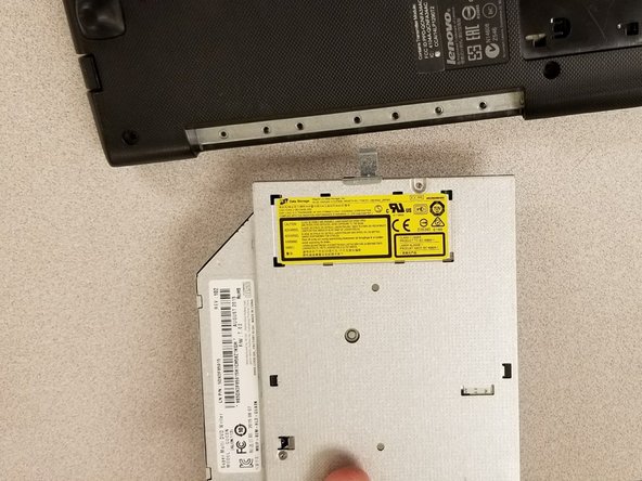

  3. Lenovo Z70-80 Motherboard Replacement, Optical Drive: crwdns2935265:03crwdnd2935265:01crwdnd2935265:03crwdne2935265:0 Lenovo Z70-80 Motherboard Replacement, Optical Drive: crwdns2935265:03crwdnd2935265:02crwdnd2935265:03crwdne2935265:0 Lenovo Z70-80 Motherboard Replacement, Optical Drive: crwdns2935265:03crwdnd2935265:03crwdnd2935265:03crwdne2935265:0
    • Remove the single 3mm Phillips #0 screw from the optical drive.
    • Pull the optical drive out of the side.

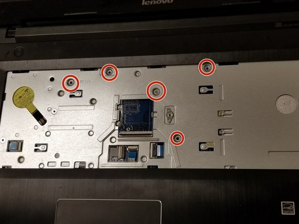

  6. Lenovo Z70-80 Motherboard Replacement: crwdns2935265:06crwdnd2935265:01crwdnd2935265:03crwdne2935265:0 Lenovo Z70-80 Motherboard Replacement: crwdns2935265:06crwdnd2935265:02crwdnd2935265:03crwdne2935265:0 Lenovo Z70-80 Motherboard Replacement: crwdns2935265:06crwdnd2935265:03crwdnd2935265:03crwdne2935265:0

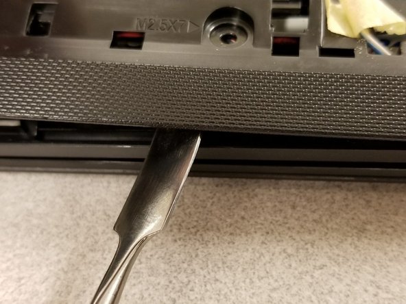

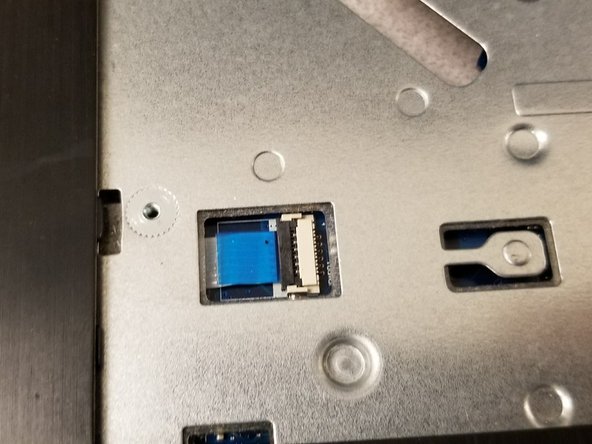

    • Pry the edges of the keyboard upwards using a spudger.
    • A cable with a ZIF connector is attached to the bottom of the keyboard. Flip the small black tab on the connector for safe removal.
    • Remove the five 3mm Phillips #0 screws.
  7. Lenovo Z70-80 Motherboard Replacement: crwdns2935265:07crwdnd2935265:01crwdnd2935265:03crwdne2935265:0 Lenovo Z70-80 Motherboard Replacement: crwdns2935265:07crwdnd2935265:02crwdnd2935265:03crwdne2935265:0 Lenovo Z70-80 Motherboard Replacement: crwdns2935265:07crwdnd2935265:03crwdnd2935265:03crwdne2935265:0
    • Remove all the ribbon cables and connectors from the front and back of the laptop.
    • Remember to flip the small black tabs on ZIF connectors for safe removal.

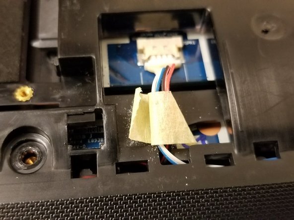

  8. Lenovo Z70-80 Motherboard Replacement: crwdns2935265:08crwdnd2935265:01crwdnd2935265:02crwdne2935265:0 Lenovo Z70-80 Motherboard Replacement: crwdns2935265:08crwdnd2935265:02crwdnd2935265:02crwdne2935265:0
    • Remove the 3mm screw and carefully pull out the cables from the hooks holding them in place.

    • Use a spudger at the edges of the laptop cover to carefully pry upwards, removing the cover.

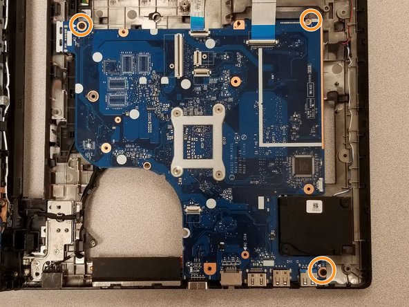

  10. Lenovo Z70-80 Motherboard Replacement: crwdns2935265:010crwdnd2935265:01crwdnd2935265:03crwdne2935265:0 Lenovo Z70-80 Motherboard Replacement: crwdns2935265:010crwdnd2935265:02crwdnd2935265:03crwdne2935265:0 Lenovo Z70-80 Motherboard Replacement: crwdns2935265:010crwdnd2935265:03crwdnd2935265:03crwdne2935265:0
    • Unplug the two black cables from the motherboard.
    • Remove the three 3mm screws from the motherboard.
    • Remove the motherboard.
    • Pick up the motherboard carefully by the edges.
