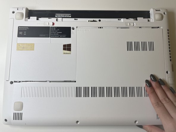

    • Close the laptop screen and flip the laptop bottom-side up.
    • Make sure the surface you are working on is dry and away from liquids and fire.

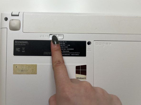

    • Slide the left battery lock to the left.
    • When it is in the unlock position, you will see red underneath the lock.
    • Slide the right lock to the right.
    • The battery case will detach from the laptop.
    • Separate the battery from the laptop.
  3. Lenovo Z40-70 Hard Drive Replacement: crwdns2935265:03crwdnd2935265:01crwdnd2935265:03crwdne2935265:0 Lenovo Z40-70 Hard Drive Replacement: crwdns2935265:03crwdnd2935265:02crwdnd2935265:03crwdne2935265:0 Lenovo Z40-70 Hard Drive Replacement: crwdns2935265:03crwdnd2935265:03crwdnd2935265:03crwdne2935265:0

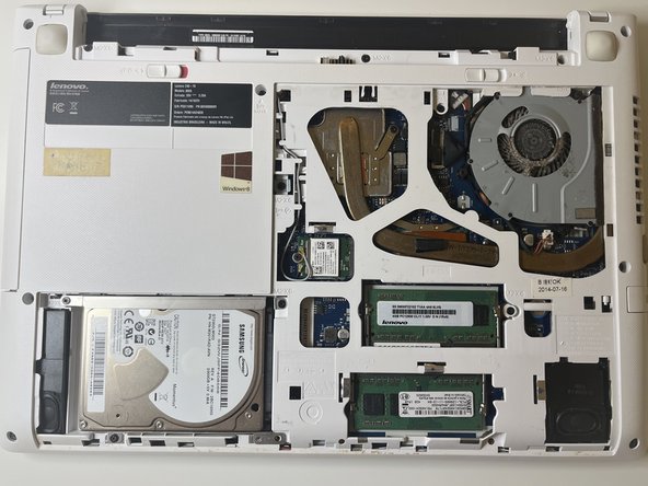

    • Use a Phillips #00 screwdriver to remove two 4 mm screws along the opposite edge of the laptop.
    • Gently slide off the back cover to reveal the hard drive.

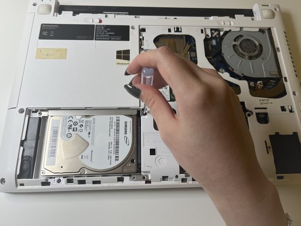

  4. Lenovo Z40-70 Hard Drive Replacement: crwdns2935265:04crwdnd2935265:01crwdnd2935265:03crwdne2935265:0 Lenovo Z40-70 Hard Drive Replacement: crwdns2935265:04crwdnd2935265:02crwdnd2935265:03crwdne2935265:0 Lenovo Z40-70 Hard Drive Replacement: crwdns2935265:04crwdnd2935265:03crwdnd2935265:03crwdne2935265:0

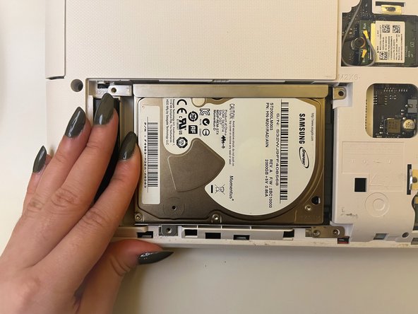

    • Use a Phillips #00 screwdriver to remove the three 5 mm screws that secure the hard drive to the laptop.
    • Slide the hard drive out from the port.

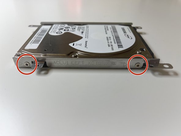

  5. Lenovo Z40-70 Hard Drive Replacement: crwdns2935265:05crwdnd2935265:01crwdnd2935265:03crwdne2935265:0 Lenovo Z40-70 Hard Drive Replacement: crwdns2935265:05crwdnd2935265:02crwdnd2935265:03crwdne2935265:0 Lenovo Z40-70 Hard Drive Replacement: crwdns2935265:05crwdnd2935265:03crwdnd2935265:03crwdne2935265:0

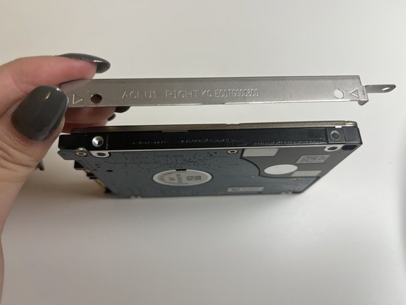

    • Use a Phillips #00 screwdriver to remove four 3 mm screws from the metal drive attachments.
    • There should be two screws on each of the long sides of the drive attachments.

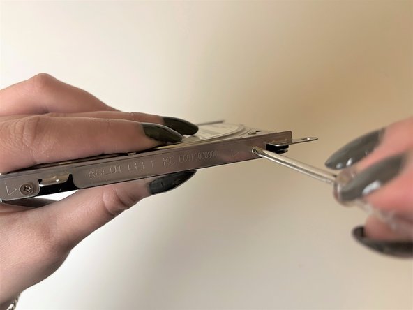

  6. Lenovo Z40-70 Hard Drive Replacement: crwdns2935265:06crwdnd2935265:01crwdnd2935265:03crwdne2935265:0 Lenovo Z40-70 Hard Drive Replacement: crwdns2935265:06crwdnd2935265:02crwdnd2935265:03crwdne2935265:0 Lenovo Z40-70 Hard Drive Replacement: crwdns2935265:06crwdnd2935265:03crwdnd2935265:03crwdne2935265:0
    • Screw the metal attachments into the new drive.
    • Make sure the holes in the attachments align with the holes in the drive.
    • Insert the drive back into its slot and slide it into the port.
    • Secure the hard drive with three PH #00 screws.

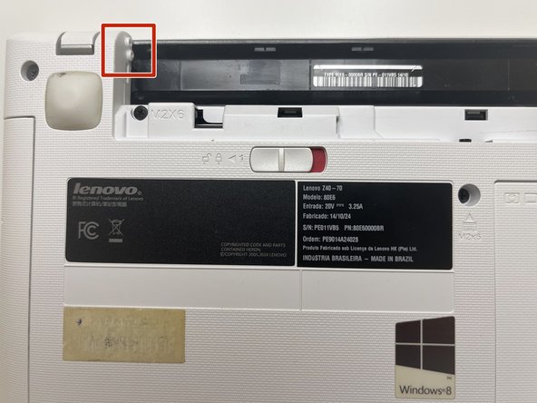

    • Slide the cover back in place and secure with two PH #00 screws.
    • Connect the heart-shaped indents to the raised parts of the battery compartment.
    • Flip the red switch to the right to lock the battery in place.
After completing the replacement, boot up your laptop as it is ready to use.
