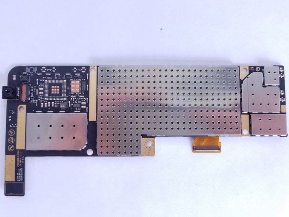

  2. Lenovo Yoga Tablet 2 830-F Motherboard Replacement: crwdns2935265:02crwdnd2935265:01crwdnd2935265:02crwdne2935265:0 Lenovo Yoga Tablet 2 830-F Motherboard Replacement: crwdns2935265:02crwdnd2935265:02crwdnd2935265:02crwdne2935265:0
    • Remove the six 3mm screws on the back of the motherboard with the Phillips Screwdriver #00 bit.
    • Remove the ribbon cables connecting the boards to the other electrical components
    • Remove ZIF connectors connecting the boards to the electrical components.
    • Some of the ribbon cables are secured with clips, simply pry up the clips before sliding them out of the pin connectors.
  3. Lenovo Yoga Tablet 2 830-F Motherboard Replacement: crwdns2935265:03crwdnd2935265:01crwdnd2935265:02crwdne2935265:0 Lenovo Yoga Tablet 2 830-F Motherboard Replacement: crwdns2935265:03crwdnd2935265:02crwdnd2935265:02crwdne2935265:0
    • Replace the motherboard with the new motherboard.
    • Be careful not to damage the ribbon cables when reassembling the device.
