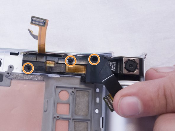

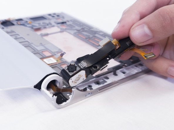

  3. Lenovo Yoga Tablet 2 830-F Camera Replacement: crwdns2935265:03crwdnd2935265:01crwdnd2935265:03crwdne2935265:0 Lenovo Yoga Tablet 2 830-F Camera Replacement: crwdns2935265:03crwdnd2935265:02crwdnd2935265:03crwdne2935265:0 Lenovo Yoga Tablet 2 830-F Camera Replacement: crwdns2935265:03crwdnd2935265:03crwdnd2935265:03crwdne2935265:0
    • After removing the motherboard and antennas the camera module is located on the right as marked in red.
    • Remove the three 2mm screws holding the module in place with the Phillips Screwdriver #00 bit.
    • The camera module is also held in place with adhesive so gently remove.
