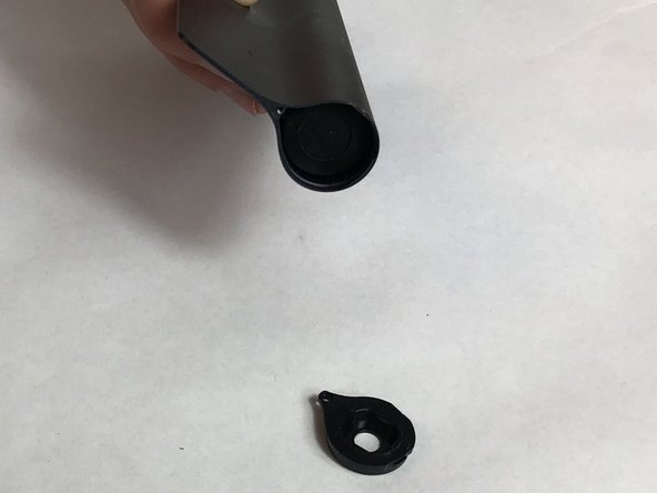

    • Pry out the end cap with a plastic spudger.
