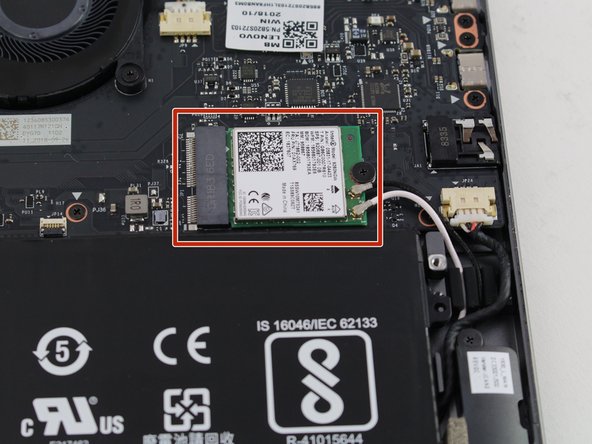

    • Find the Wi-Fi card located on the right just above the battery. It is a green chip with a white label that says "Intel 9260" somewhere on it.

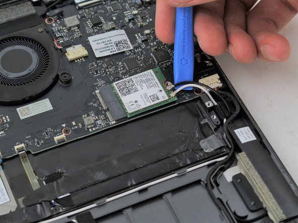

  6. Lenovo Yoga C930-13IKB Wi-Fi Card Replacement: crwdns2935265:06crwdnd2935265:01crwdnd2935265:03crwdne2935265:0 Lenovo Yoga C930-13IKB Wi-Fi Card Replacement: crwdns2935265:06crwdnd2935265:02crwdnd2935265:03crwdne2935265:0 Lenovo Yoga C930-13IKB Wi-Fi Card Replacement: crwdns2935265:06crwdnd2935265:03crwdnd2935265:03crwdne2935265:0

    • Gently pull or use the iFixit opening tool to detach the black and white wires from the card.
    • When reassembling, these wires are difficult to reattach, so be patient. Line the wires up with your fingers and press down on the connections with the opening tool.

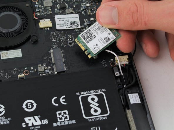

  7. Lenovo Yoga C930-13IKB Wi-Fi Card Replacement: crwdns2935265:07crwdnd2935265:01crwdnd2935265:02crwdne2935265:0 Lenovo Yoga C930-13IKB Wi-Fi Card Replacement: crwdns2935265:07crwdnd2935265:02crwdnd2935265:02crwdne2935265:0
    • Pinch the card on either side and pull to the right to unplug it from the motherboard.
