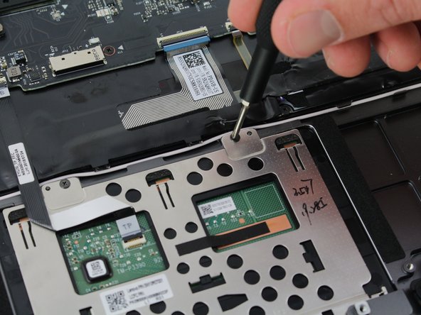

  7. Lenovo Yoga C930-13IKB Touch Pad Replacement, Touch Pad: crwdns2935265:07crwdnd2935265:01crwdnd2935265:02crwdne2935265:0 Lenovo Yoga C930-13IKB Touch Pad Replacement, Touch Pad: crwdns2935265:07crwdnd2935265:02crwdnd2935265:02crwdne2935265:0
    • Unscrew the four 2 mm screws with a Phillips #00 screwdriver.
  8. Lenovo Yoga C930-13IKB Touch Pad Replacement: crwdns2935265:08crwdnd2935265:01crwdnd2935265:03crwdne2935265:0 Lenovo Yoga C930-13IKB Touch Pad Replacement: crwdns2935265:08crwdnd2935265:02crwdnd2935265:03crwdne2935265:0 Lenovo Yoga C930-13IKB Touch Pad Replacement: crwdns2935265:08crwdnd2935265:03crwdnd2935265:03crwdne2935265:0
    • Carefully pull out the small electrical wire from the back of the touch pad.
  9. Lenovo Yoga C930-13IKB Touch Pad Replacement: crwdns2935265:09crwdnd2935265:01crwdnd2935265:02crwdne2935265:0 Lenovo Yoga C930-13IKB Touch Pad Replacement: crwdns2935265:09crwdnd2935265:02crwdnd2935265:02crwdne2935265:0
    • The touch pad must be slid out before being lifted out.
    • Lift up the touch pad.
    • Slide the touch pad out of the laptop.
