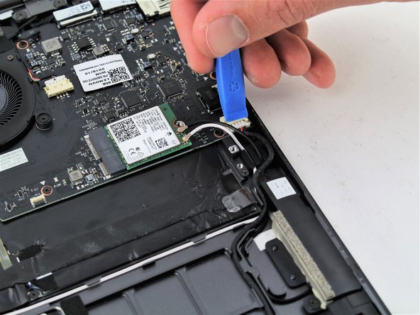

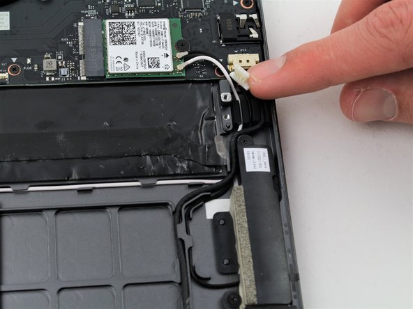

    • Gently unplug the connector using two fingers.
    • Use an opening tool if needed.

    • Lift the black wire that connects the speakers to the motherboard from its track using an opening tool.
    • Press the wire down firmly and in the right track when reassembling.
  10. Lenovo Yoga C930-13IKB Speaker Replacement: crwdns2935265:010crwdnd2935265:01crwdnd2935265:02crwdne2935265:0 Lenovo Yoga C930-13IKB Speaker Replacement: crwdns2935265:010crwdnd2935265:02crwdnd2935265:02crwdne2935265:0
    • Remove the right speaker using your fingers.
    • Remove the left speaker, which is connected to the right speaker by the black and red wire.
    • When reassembling, make sure the black and red wire is in the right track so that you are able to put the back cover back without wire poking out.
