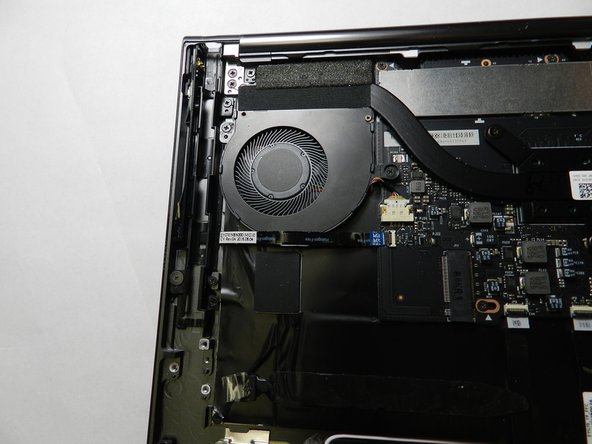

  9. Lenovo Yoga C930-13IKB Power Button Board Replacement, Power Button Board: crwdns2935265:09crwdnd2935265:01crwdnd2935265:03crwdne2935265:0 Lenovo Yoga C930-13IKB Power Button Board Replacement, Power Button Board: crwdns2935265:09crwdnd2935265:02crwdnd2935265:03crwdne2935265:0 Lenovo Yoga C930-13IKB Power Button Board Replacement, Power Button Board: crwdns2935265:09crwdnd2935265:03crwdnd2935265:03crwdne2935265:0
    • Unscrew the two 2mm screws using a Phillips #00 screwdriver.
    • Gently lift out the digital pen spring using the iFixit opening tool.

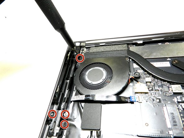

  10. Lenovo Yoga C930-13IKB Power Button Board Replacement: crwdns2935265:010crwdnd2935265:01crwdnd2935265:03crwdne2935265:0 Lenovo Yoga C930-13IKB Power Button Board Replacement: crwdns2935265:010crwdnd2935265:02crwdnd2935265:03crwdne2935265:0 Lenovo Yoga C930-13IKB Power Button Board Replacement: crwdns2935265:010crwdnd2935265:03crwdnd2935265:03crwdne2935265:0
    • Remove four 2 mm screws from the digital pen holder using a Phillips #00 screwdriver.
    • Do not remove the pen holder until the attached ribbon cable is uninstalled.

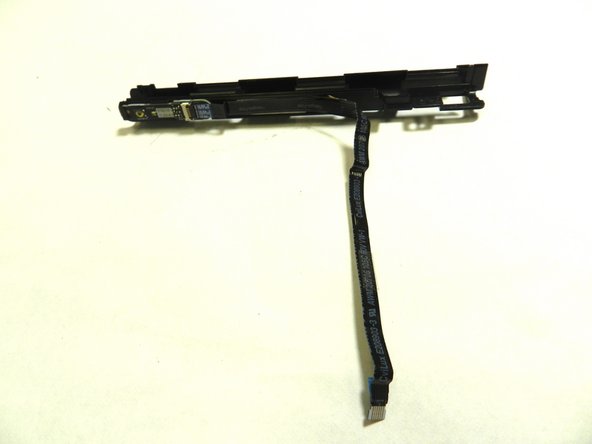

  12. Lenovo Yoga C930-13IKB Power Button Board Replacement: crwdns2935265:012crwdnd2935265:01crwdnd2935265:02crwdne2935265:0 Lenovo Yoga C930-13IKB Power Button Board Replacement: crwdns2935265:012crwdnd2935265:02crwdnd2935265:02crwdne2935265:0
    • Carefully lift out the digital pen holder with the attached power button ribbon cable.

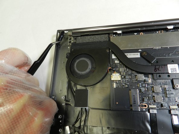

  13. Lenovo Yoga C930-13IKB Power Button Board Replacement: crwdns2935265:013crwdnd2935265:01crwdnd2935265:03crwdne2935265:0 Lenovo Yoga C930-13IKB Power Button Board Replacement: crwdns2935265:013crwdnd2935265:02crwdnd2935265:03crwdne2935265:0 Lenovo Yoga C930-13IKB Power Button Board Replacement: crwdns2935265:013crwdnd2935265:03crwdnd2935265:03crwdne2935265:0
    • Depress the power button, then gently pull and detach it using the angled ESD tweezers.
