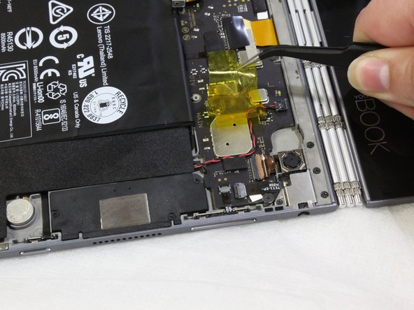

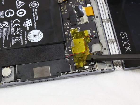

    • Peel the yellowish covering off, using the flat end of the spudger to pry it up and the tweezers to pull it off gently.
  7. Lenovo Yoga Book X90F Speakers Replacement: crwdns2935265:07crwdnd2935265:01crwdnd2935265:02crwdne2935265:0 Lenovo Yoga Book X90F Speakers Replacement: crwdns2935265:07crwdnd2935265:02crwdnd2935265:02crwdne2935265:0
    • Remove black covering from device.

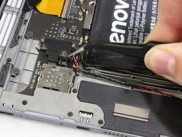

  8. Lenovo Yoga Book X90F Speakers Replacement: crwdns2935265:08crwdnd2935265:01crwdnd2935265:02crwdne2935265:0 Lenovo Yoga Book X90F Speakers Replacement: crwdns2935265:08crwdnd2935265:02crwdnd2935265:02crwdne2935265:0
    • Use tweezers to unplug the intertwined black and red wires.
