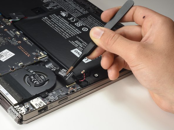

    • Disconnect the red and black wire connected to the speaker using the iFixit Tweezers.
  4. Lenovo Yoga 920-13IKB USB 3.0 Port Replacement: crwdns2935265:04crwdnd2935265:01crwdnd2935265:01crwdne2935265:0

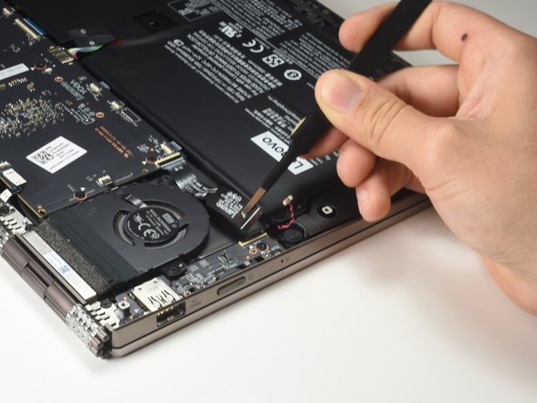

    • Lift up the black tab on the flat cable connector with the iFixit Opening Tool.
  5. Lenovo Yoga 920-13IKB USB 3.0 Port Replacement: crwdns2935265:05crwdnd2935265:01crwdnd2935265:03crwdne2935265:0 Lenovo Yoga 920-13IKB USB 3.0 Port Replacement: crwdns2935265:05crwdnd2935265:02crwdnd2935265:03crwdne2935265:0 Lenovo Yoga 920-13IKB USB 3.0 Port Replacement: crwdns2935265:05crwdnd2935265:03crwdnd2935265:03crwdne2935265:0
    • Flip up the tab using the iFixit Tweezers to release the flat cable.

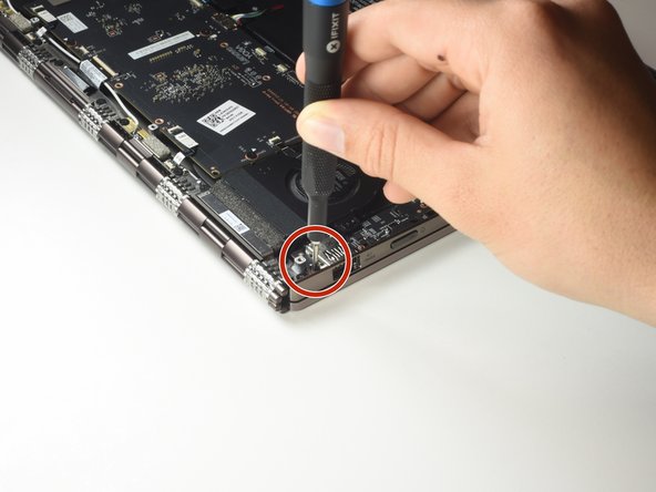

  6. Lenovo Yoga 920-13IKB USB 3.0 Port Replacement: crwdns2935265:06crwdnd2935265:01crwdnd2935265:02crwdne2935265:0 Lenovo Yoga 920-13IKB USB 3.0 Port Replacement: crwdns2935265:06crwdnd2935265:02crwdnd2935265:02crwdne2935265:0
    • Undo the two 3mm Phillips #00 screws to loosen the USB 3.0 board.

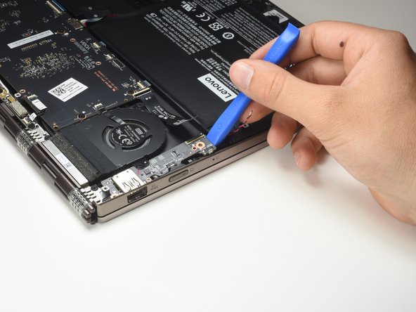

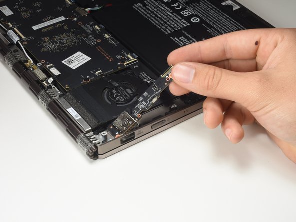

  7. Lenovo Yoga 920-13IKB USB 3.0 Port Replacement: crwdns2935265:07crwdnd2935265:01crwdnd2935265:03crwdne2935265:0 Lenovo Yoga 920-13IKB USB 3.0 Port Replacement: crwdns2935265:07crwdnd2935265:02crwdnd2935265:03crwdne2935265:0 Lenovo Yoga 920-13IKB USB 3.0 Port Replacement: crwdns2935265:07crwdnd2935265:03crwdnd2935265:03crwdne2935265:0
    • Remove the USB 3.0 Board from the device using the iFixit Opening Tool.

Just wanted to say thank you to Alyssa and the others who contributed to this.
I just used your guide to fix a problem with my Yoga constantly entering and waking (repeatedly, seconds apart) from connected sleep mode. Infuriating. It was accompanied by the USB connect/disconnect sound as well.
Using the Event Viewer I managed to find out it was entering sleep mode in response to the power button (which I wasn’t pressing). So, I used your guide to disconnect and reconnect the USB board and it has resolved my issue.
iFixIt gained some tools income, you gained some more reputation points, and I gained a laptop that’s behaving itself now!
Now, what else can I break? ;o)
