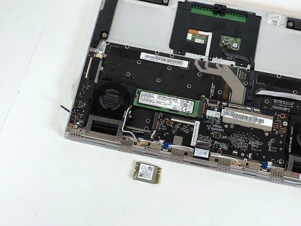

  4. Lenovo Yoga 910-13IKB Wi-Fi Card Replacement, Wi-Fi Card: crwdns2935265:04crwdnd2935265:01crwdnd2935265:01crwdne2935265:0
    • Remove the single 1 mm screw at left of Wi-Fi card with a Phillips #0 screwdriver.

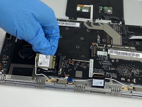

  5. Lenovo Yoga 910-13IKB Wi-Fi Card Replacement: crwdns2935265:05crwdnd2935265:01crwdnd2935265:02crwdne2935265:0 Lenovo Yoga 910-13IKB Wi-Fi Card Replacement: crwdns2935265:05crwdnd2935265:02crwdnd2935265:02crwdne2935265:0
    • Pull the Wi-Fi card out of the slot on the motherboard.
    • It is still connected to the coaxial cables so don't yank it out or those connections will break.
  6. Lenovo Yoga 910-13IKB Wi-Fi Card Replacement: crwdns2935265:06crwdnd2935265:01crwdnd2935265:03crwdne2935265:0 Lenovo Yoga 910-13IKB Wi-Fi Card Replacement: crwdns2935265:06crwdnd2935265:02crwdnd2935265:03crwdne2935265:0 Lenovo Yoga 910-13IKB Wi-Fi Card Replacement: crwdns2935265:06crwdnd2935265:03crwdnd2935265:03crwdne2935265:0
    • Detach the white wire that is connected to the Wi-Fi card by applying gentle pressure.
    • Detach the black wire by applying gentle pressure.
