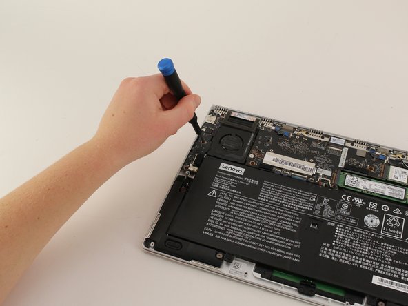

  9. Lenovo Yoga 910-13IKB USB Ports Replacement, USB Ports: crwdns2935265:09crwdnd2935265:01crwdnd2935265:03crwdne2935265:0 Lenovo Yoga 910-13IKB USB Ports Replacement, USB Ports: crwdns2935265:09crwdnd2935265:02crwdnd2935265:03crwdne2935265:0 Lenovo Yoga 910-13IKB USB Ports Replacement, USB Ports: crwdns2935265:09crwdnd2935265:03crwdnd2935265:03crwdne2935265:0
    • Remove the five 3mm JIS #00 screws holding the array of ports in place.

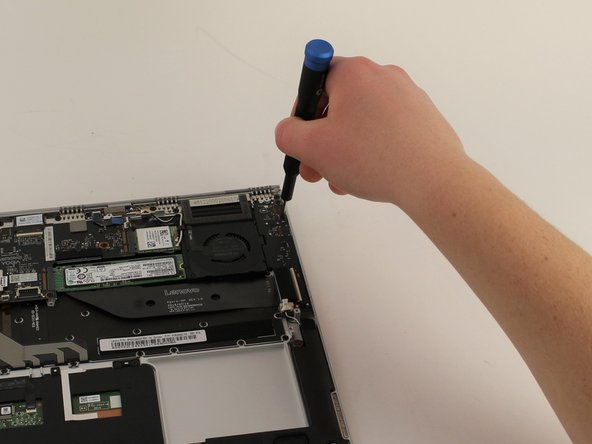

  10. Lenovo Yoga 910-13IKB USB Ports Replacement: crwdns2935265:010crwdnd2935265:01crwdnd2935265:01crwdne2935265:0
    • Lift up on the cover on top of the ribbon connector and gently pull the ribbon cable out.
  11. Lenovo Yoga 910-13IKB USB Ports Replacement: crwdns2935265:011crwdnd2935265:01crwdnd2935265:01crwdne2935265:0
    • Lift up on the component and remove it.
  12. Lenovo Yoga 910-13IKB USB Ports Replacement: crwdns2935265:012crwdnd2935265:01crwdnd2935265:01crwdne2935265:0
    • Repeat the same process on the opposite side, lifting up on the connector cover and pulling the ribbon cable out of its place.
  13. Lenovo Yoga 910-13IKB USB Ports Replacement: crwdns2935265:013crwdnd2935265:01crwdnd2935265:01crwdne2935265:0
    • Lift up on the set of ports and remove it from the device.
