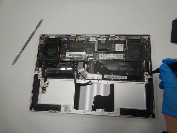

  4. Lenovo Yoga 910-13IKB Trackpad Replacement, Trackpad: crwdns2935265:04crwdnd2935265:01crwdnd2935265:03crwdne2935265:0 Lenovo Yoga 910-13IKB Trackpad Replacement, Trackpad: crwdns2935265:04crwdnd2935265:02crwdnd2935265:03crwdne2935265:0 Lenovo Yoga 910-13IKB Trackpad Replacement, Trackpad: crwdns2935265:04crwdnd2935265:03crwdnd2935265:03crwdne2935265:0
    • Using the Phillips #0 screwdriver, remove all six screws holding the trackpad to the device.
    • Find the ribbon cable, the black bundle of wires attached to the trackpad, and lift the head of the ribbon cable towards you.
    • Carefully lift up the trackpad and remove it from the device.
