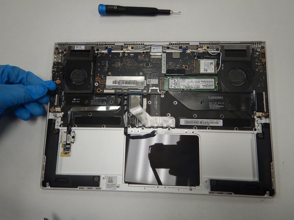

  6. Lenovo Yoga 910-13IKB Motherboard Replacement: crwdns2935265:06crwdnd2935265:01crwdnd2935265:03crwdne2935265:0 Lenovo Yoga 910-13IKB Motherboard Replacement: crwdns2935265:06crwdnd2935265:02crwdnd2935265:03crwdne2935265:0 Lenovo Yoga 910-13IKB Motherboard Replacement: crwdns2935265:06crwdnd2935265:03crwdnd2935265:03crwdne2935265:0
    • Remove the screws attached to the SSD stick with a Phillips #0 screwdriver.
    • Pull the SSD stick directly to the right until it shifts out of place to remove it.
    • Storage chip above it (further away from you) may also be detached by pulling it directly to the right until it clicks out.

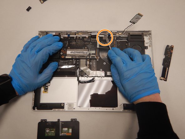

  7. Lenovo Yoga 910-13IKB Motherboard Replacement: crwdns2935265:07crwdnd2935265:01crwdnd2935265:02crwdne2935265:0 Lenovo Yoga 910-13IKB Motherboard Replacement: crwdns2935265:07crwdnd2935265:02crwdnd2935265:02crwdne2935265:0
    • Remove the four screws attached to both fans, and the back connector strip (the long metal piece furthest from you with screws in it) with a Phillips #0 screwdriver.

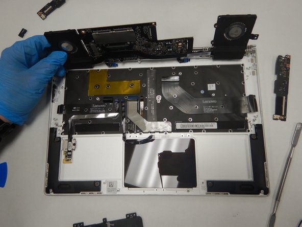

  8. Lenovo Yoga 910-13IKB Motherboard Replacement: crwdns2935265:08crwdnd2935265:01crwdnd2935265:03crwdne2935265:0 Lenovo Yoga 910-13IKB Motherboard Replacement: crwdns2935265:08crwdnd2935265:02crwdnd2935265:03crwdne2935265:0 Lenovo Yoga 910-13IKB Motherboard Replacement: crwdns2935265:08crwdnd2935265:03crwdnd2935265:03crwdne2935265:0
    • Remove the screws attached to the motherboard with a Phillips #0 screwdriver.
    • Remove the back connector strip using a spudger or plastic opening tool to pry it off of the device.
    • With the back connector strip removed, pry the motherboard up and off of the device.
