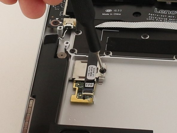

  9. Lenovo Yoga 910-13IKB Fingerprint Reader Replacement, Fingerprint Reader: crwdns2935265:09crwdnd2935265:01crwdnd2935265:02crwdne2935265:0 Lenovo Yoga 910-13IKB Fingerprint Reader Replacement, Fingerprint Reader: crwdns2935265:09crwdnd2935265:02crwdnd2935265:02crwdne2935265:0
    • Remove the one 3mm JIS #00 screw on the right side of the silver component.

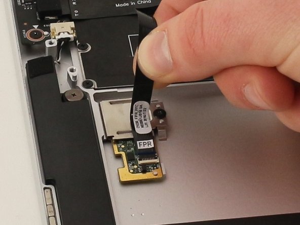

  10. Lenovo Yoga 910-13IKB Fingerprint Reader Replacement: crwdns2935265:010crwdnd2935265:01crwdnd2935265:02crwdne2935265:0 Lenovo Yoga 910-13IKB Fingerprint Reader Replacement: crwdns2935265:010crwdnd2935265:02crwdnd2935265:02crwdne2935265:0
    • Gently pull up on the ribbon cable to detach it from the metal housing.
