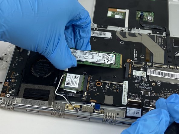

  4. Lenovo Yoga 910-13IKB Fan Replacement, Fan: crwdns2935265:04crwdnd2935265:01crwdnd2935265:02crwdne2935265:0 Lenovo Yoga 910-13IKB Fan Replacement, Fan: crwdns2935265:04crwdnd2935265:02crwdnd2935265:02crwdne2935265:0
    • Remove the screws attached to the SSD stick by using a Phillips #0 screwdriver.
    • Pull the SSD stick directly to the right until it shifts out of place to remove it.

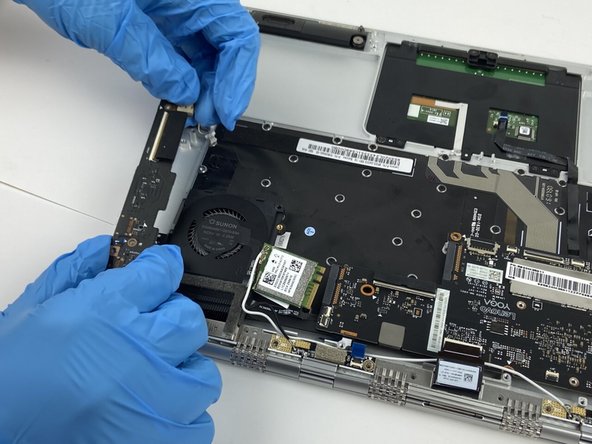

  5. Lenovo Yoga 910-13IKB Fan Replacement: crwdns2935265:05crwdnd2935265:01crwdnd2935265:03crwdne2935265:0 Lenovo Yoga 910-13IKB Fan Replacement: crwdns2935265:05crwdnd2935265:02crwdnd2935265:03crwdne2935265:0 Lenovo Yoga 910-13IKB Fan Replacement: crwdns2935265:05crwdnd2935265:03crwdnd2935265:03crwdne2935265:0
    • Lift the labeled flap seal and remove the ribbon cable that connects the USB ports to the motherboard and gently pull away.
    • Be gentle when detaching the cables, the attachment port is easy to damage.

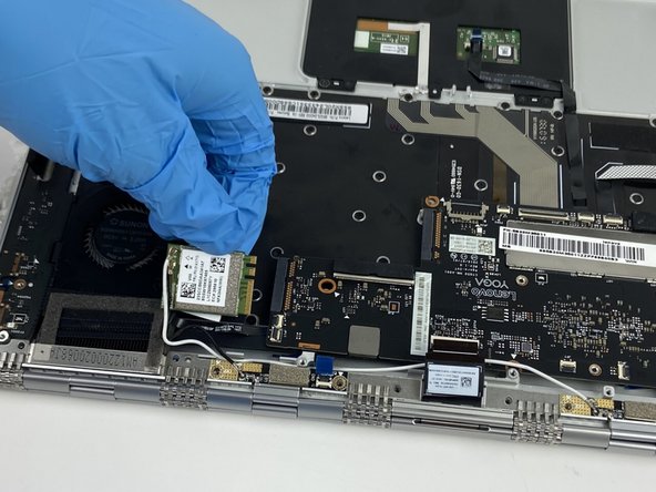

  6. Lenovo Yoga 910-13IKB Fan Replacement: crwdns2935265:06crwdnd2935265:01crwdnd2935265:03crwdne2935265:0 Lenovo Yoga 910-13IKB Fan Replacement: crwdns2935265:06crwdnd2935265:02crwdnd2935265:03crwdne2935265:0 Lenovo Yoga 910-13IKB Fan Replacement: crwdns2935265:06crwdnd2935265:03crwdnd2935265:03crwdne2935265:0

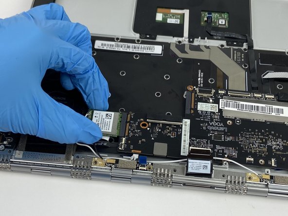

    • Unscrew the single 1 mm screw at the left of Wi-Fi card with a Phillips #0 screwdriver.
    • Remove the Wi-Fi card by gently pulling the card to the left.

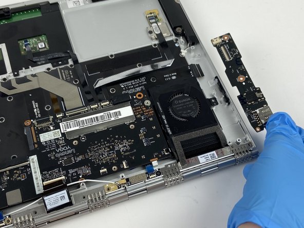

  7. Lenovo Yoga 910-13IKB Fan Replacement: crwdns2935265:07crwdnd2935265:01crwdnd2935265:03crwdne2935265:0 Lenovo Yoga 910-13IKB Fan Replacement: crwdns2935265:07crwdnd2935265:02crwdnd2935265:03crwdne2935265:0 Lenovo Yoga 910-13IKB Fan Replacement: crwdns2935265:07crwdnd2935265:03crwdnd2935265:03crwdne2935265:0
    • Unscrew three 1 mm screws on the rightmost USB port board using a Phillips #0 screwdriver.
    • Remove the rightmost USB port board by pulling it up and out.

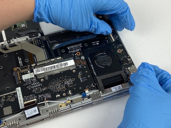

  8. Lenovo Yoga 910-13IKB Fan Replacement: crwdns2935265:08crwdnd2935265:01crwdnd2935265:03crwdne2935265:0 Lenovo Yoga 910-13IKB Fan Replacement: crwdns2935265:08crwdnd2935265:02crwdnd2935265:03crwdne2935265:0 Lenovo Yoga 910-13IKB Fan Replacement: crwdns2935265:08crwdnd2935265:03crwdnd2935265:03crwdne2935265:0
    • Unscrew the four 1 mm screws on the leftmost USB port using a Phillips #0 screwdriver.
    • Remove the leftmost USB port board by pulling it up and out.

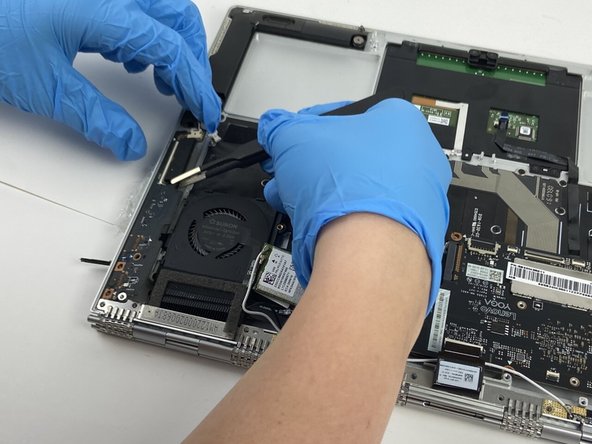

    • Gently pull the Back Connector strip towards you, this will safely disconnect it.
    • Disconnect the two Upper Connector Strips by using Tweezers and unclipping the upper tab.
    • Be cautious not to rip the strips or parts.

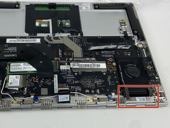

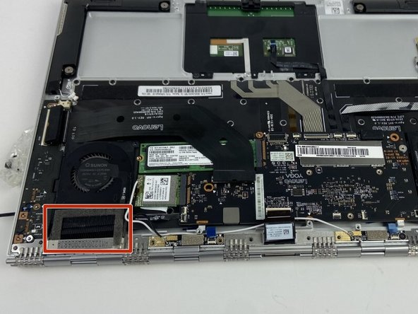

  11. Lenovo Yoga 910-13IKB Fan Replacement: crwdns2935265:011crwdnd2935265:01crwdnd2935265:03crwdne2935265:0 Lenovo Yoga 910-13IKB Fan Replacement: crwdns2935265:011crwdnd2935265:02crwdnd2935265:03crwdne2935265:0 Lenovo Yoga 910-13IKB Fan Replacement: crwdns2935265:011crwdnd2935265:03crwdnd2935265:03crwdne2935265:0
    • Gently peel up the sticky adhesive attaching the fan to the hinge.
    • Be very careful with the ports when removing to not damage anything else.

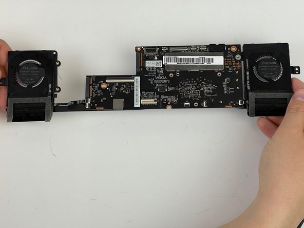

  12. Lenovo Yoga 910-13IKB Fan Replacement: crwdns2935265:012crwdnd2935265:01crwdnd2935265:02crwdne2935265:0 Lenovo Yoga 910-13IKB Fan Replacement: crwdns2935265:012crwdnd2935265:02crwdnd2935265:02crwdne2935265:0

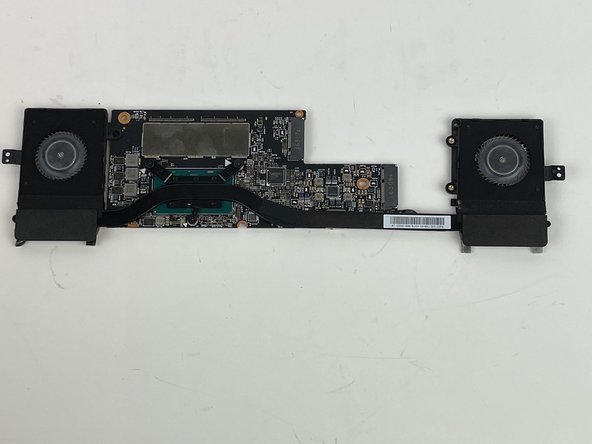

    • Remove the motherboard and fan by pulling away and up from the hinge.
  13. Lenovo Yoga 910-13IKB Fan Replacement: crwdns2935265:013crwdnd2935265:01crwdnd2935265:02crwdne2935265:0 Lenovo Yoga 910-13IKB Fan Replacement: crwdns2935265:013crwdnd2935265:02crwdnd2935265:02crwdne2935265:0
    • Flip the component to the opposite side.

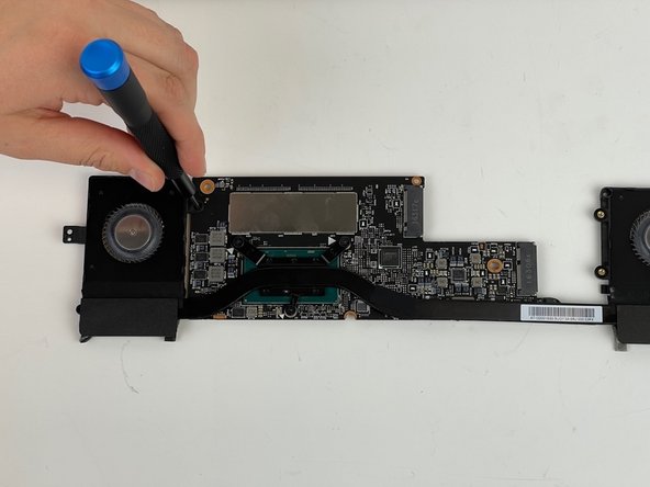

  14. Lenovo Yoga 910-13IKB Fan Replacement: crwdns2935265:014crwdnd2935265:01crwdnd2935265:02crwdne2935265:0 Lenovo Yoga 910-13IKB Fan Replacement: crwdns2935265:014crwdnd2935265:02crwdnd2935265:02crwdne2935265:0
    • Remove three 1 mm screws using a Phillips #0 screwdriver.
