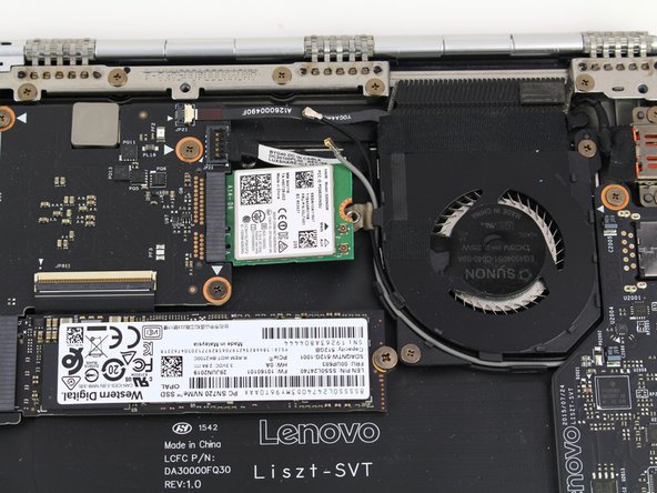

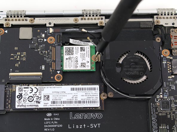

  5. Lenovo Yoga 900-13ISK Wi-Fi Card Replacement, Wi-Fi Card: crwdns2935265:05crwdnd2935265:01crwdnd2935265:03crwdne2935265:0 Lenovo Yoga 900-13ISK Wi-Fi Card Replacement, Wi-Fi Card: crwdns2935265:05crwdnd2935265:02crwdnd2935265:03crwdne2935265:0 Lenovo Yoga 900-13ISK Wi-Fi Card Replacement, Wi-Fi Card: crwdns2935265:05crwdnd2935265:03crwdnd2935265:03crwdne2935265:0
    • Pry up the white and black coaxial cables from the Wi-Fi card using a spudger.
    • Move the cables to the side.

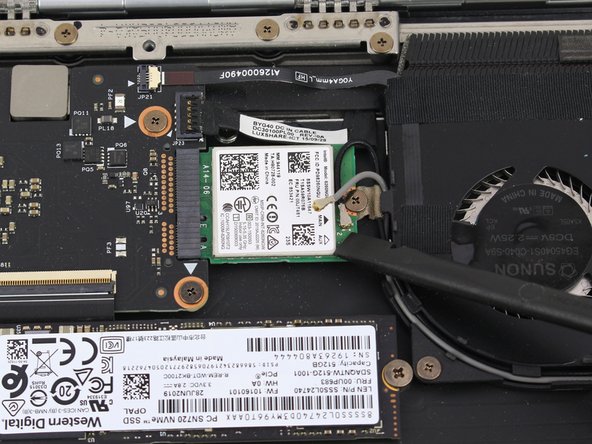

  6. Lenovo Yoga 900-13ISK Wi-Fi Card Replacement: crwdns2935265:06crwdnd2935265:01crwdnd2935265:03crwdne2935265:0 Lenovo Yoga 900-13ISK Wi-Fi Card Replacement: crwdns2935265:06crwdnd2935265:02crwdnd2935265:03crwdne2935265:0 Lenovo Yoga 900-13ISK Wi-Fi Card Replacement: crwdns2935265:06crwdnd2935265:03crwdnd2935265:03crwdne2935265:0
    • Using a Phillips #00 screwdriver, remove the 2.2 mm screw holding down the Wi-Fi card.
    • The Wi-Fi card may pop up to rest at an angle to the motherboard after the screw is removed.

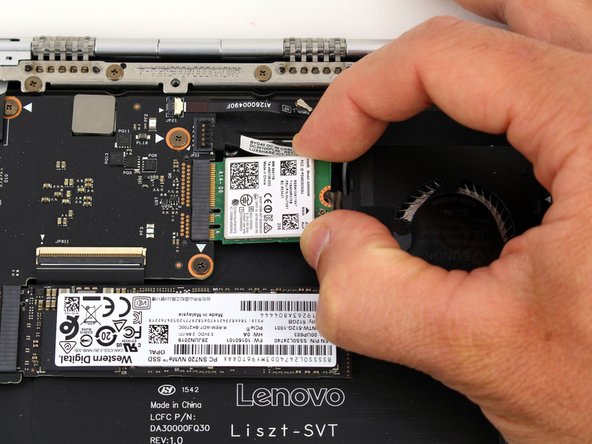

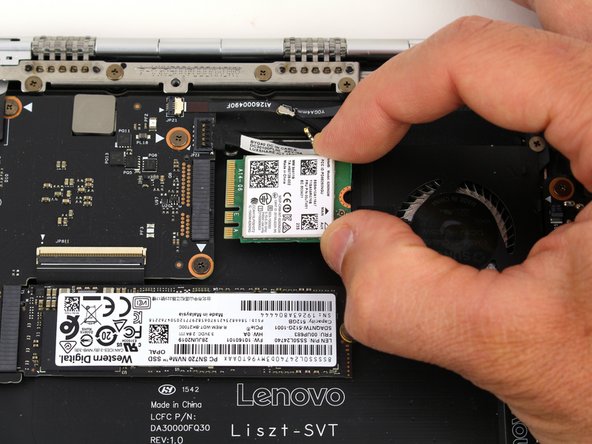

  7. Lenovo Yoga 900-13ISK Wi-Fi Card Replacement: crwdns2935265:07crwdnd2935265:01crwdnd2935265:03crwdne2935265:0 Lenovo Yoga 900-13ISK Wi-Fi Card Replacement: crwdns2935265:07crwdnd2935265:02crwdnd2935265:03crwdne2935265:0 Lenovo Yoga 900-13ISK Wi-Fi Card Replacement: crwdns2935265:07crwdnd2935265:03crwdnd2935265:03crwdne2935265:0
    • Pull the Wi-Fi card out from the connector on the motherboard.
