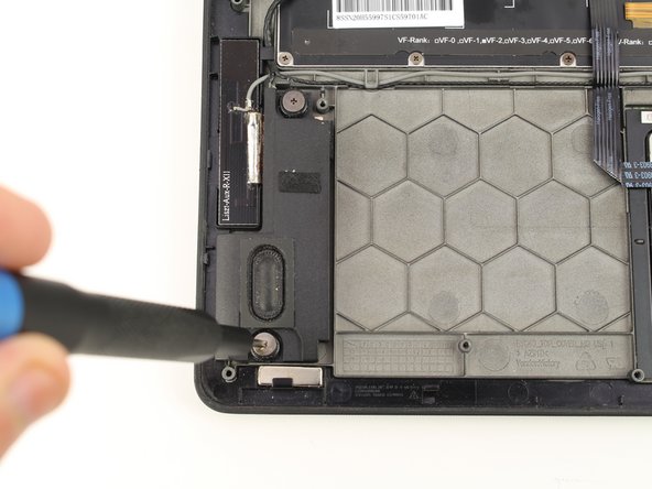

  6. Lenovo Yoga 900-13ISK Speakers Replacement: crwdns2935265:06crwdnd2935265:01crwdnd2935265:03crwdne2935265:0 Lenovo Yoga 900-13ISK Speakers Replacement: crwdns2935265:06crwdnd2935265:02crwdnd2935265:03crwdne2935265:0 Lenovo Yoga 900-13ISK Speakers Replacement: crwdns2935265:06crwdnd2935265:03crwdnd2935265:03crwdne2935265:0
    • Remove the four 2.4 mm Phillips #00 screws from the speakers on either side of the case. (two screws per speaker)

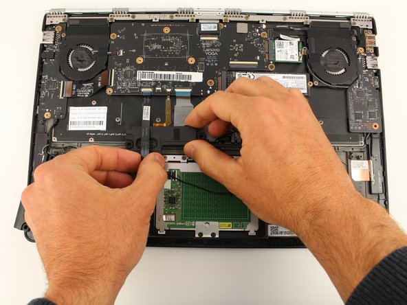

  7. Lenovo Yoga 900-13ISK Speakers Replacement: crwdns2935265:07crwdnd2935265:01crwdnd2935265:03crwdne2935265:0 Lenovo Yoga 900-13ISK Speakers Replacement: crwdns2935265:07crwdnd2935265:02crwdnd2935265:03crwdne2935265:0 Lenovo Yoga 900-13ISK Speakers Replacement: crwdns2935265:07crwdnd2935265:03crwdnd2935265:03crwdne2935265:0
    • Lift up the speaker on the right and start unwinding the cable from the hooks.
    • Thread the right speaker underneath the trackpad ribbon cable.

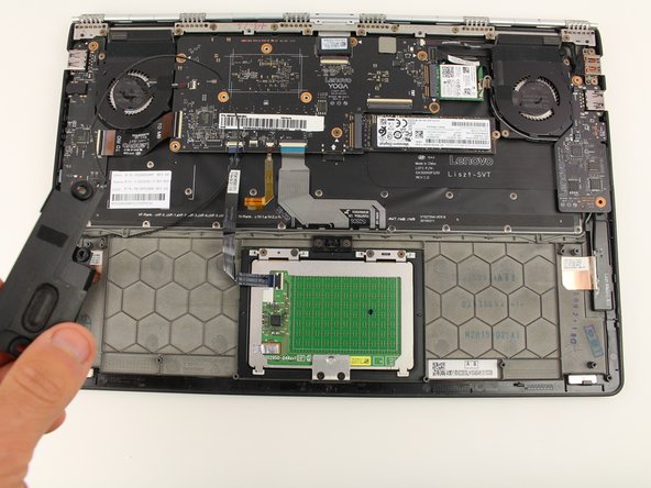

  8. Lenovo Yoga 900-13ISK Speakers Replacement: crwdns2935265:08crwdnd2935265:01crwdnd2935265:01crwdne2935265:0
    • Continue unwinding the speaker cables from the hooks until the entire assembly is free from the case.
