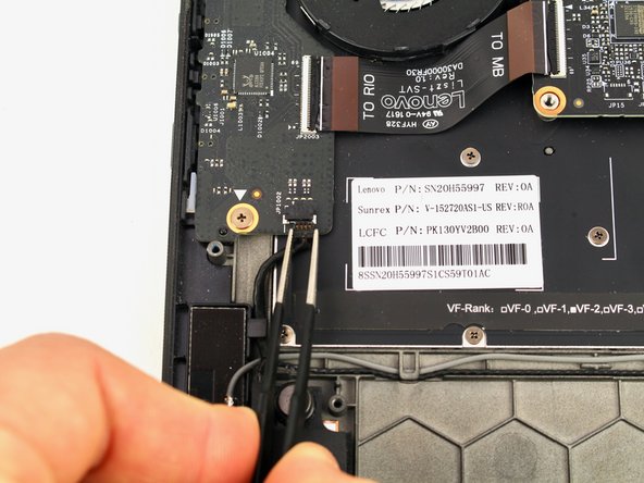

  5. Lenovo Yoga 900-13ISK Right Daughterboard Replacement, Right Daughterboard: crwdns2935265:05crwdnd2935265:01crwdnd2935265:03crwdne2935265:0 Lenovo Yoga 900-13ISK Right Daughterboard Replacement, Right Daughterboard: crwdns2935265:05crwdnd2935265:02crwdnd2935265:03crwdne2935265:0 Lenovo Yoga 900-13ISK Right Daughterboard Replacement, Right Daughterboard: crwdns2935265:05crwdnd2935265:03crwdnd2935265:03crwdne2935265:0
    • Use a pair of blunt nose tweezers or your fingers to pull out the speaker cable from the connector on the lower portion of the daughterboard.
  6. Lenovo Yoga 900-13ISK Right Daughterboard Replacement: crwdns2935265:06crwdnd2935265:01crwdnd2935265:03crwdne2935265:0 Lenovo Yoga 900-13ISK Right Daughterboard Replacement: crwdns2935265:06crwdnd2935265:02crwdnd2935265:03crwdne2935265:0 Lenovo Yoga 900-13ISK Right Daughterboard Replacement: crwdns2935265:06crwdnd2935265:03crwdnd2935265:03crwdne2935265:0
    • Using a Phillips #00 screwdriver, remove the two 3.6 mm screws from the daughterboard.

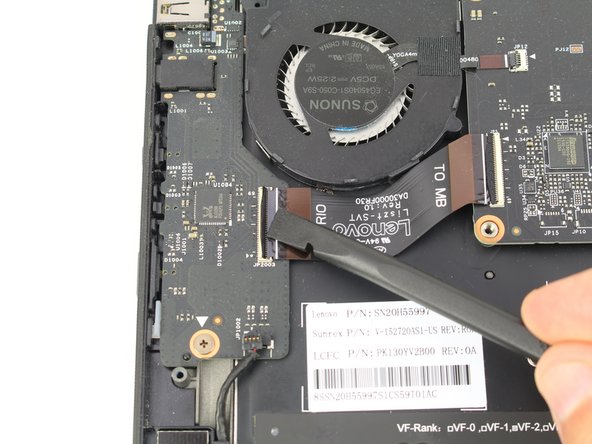

  7. Lenovo Yoga 900-13ISK Right Daughterboard Replacement: crwdns2935265:07crwdnd2935265:01crwdnd2935265:03crwdne2935265:0 Lenovo Yoga 900-13ISK Right Daughterboard Replacement: crwdns2935265:07crwdnd2935265:02crwdnd2935265:03crwdne2935265:0 Lenovo Yoga 900-13ISK Right Daughterboard Replacement: crwdns2935265:07crwdnd2935265:03crwdnd2935265:03crwdne2935265:0
    • Use a spudger to lift up the black locking tab of the ZIF connector holding the interconnect cable.
    • Pull out the interconnect cable with a pair of blunt nose tweezers.

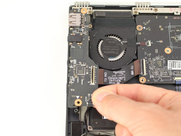

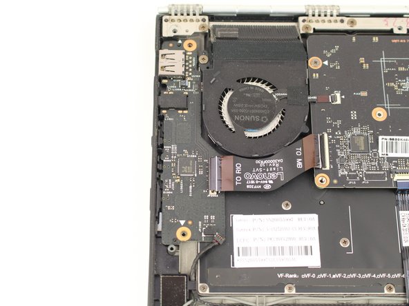

  8. Lenovo Yoga 900-13ISK Right Daughterboard Replacement: crwdns2935265:08crwdnd2935265:01crwdnd2935265:02crwdne2935265:0 Lenovo Yoga 900-13ISK Right Daughterboard Replacement: crwdns2935265:08crwdnd2935265:02crwdnd2935265:02crwdne2935265:0
    • Pick up the daughterboard from the right side and lift it out from the case.
