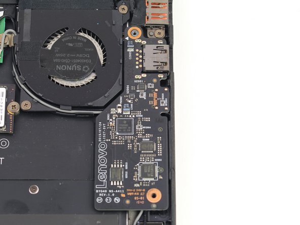

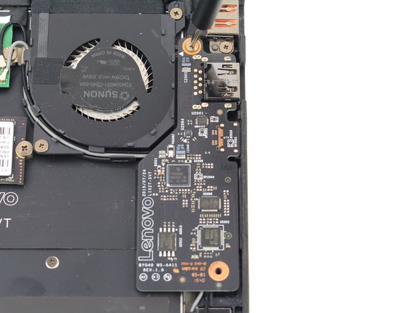

  5. Lenovo Yoga 900-13ISK Left Daughterboard Replacement, Left Daughterboard: crwdns2935265:05crwdnd2935265:01crwdnd2935265:03crwdne2935265:0 Lenovo Yoga 900-13ISK Left Daughterboard Replacement, Left Daughterboard: crwdns2935265:05crwdnd2935265:02crwdnd2935265:03crwdne2935265:0 Lenovo Yoga 900-13ISK Left Daughterboard Replacement, Left Daughterboard: crwdns2935265:05crwdnd2935265:03crwdnd2935265:03crwdne2935265:0
    • Remove the single 3.6 mm screw from the daughterboard with a Phillips #00 screwdriver.

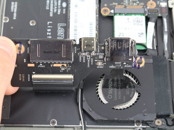

  6. Lenovo Yoga 900-13ISK Left Daughterboard Replacement: crwdns2935265:06crwdnd2935265:01crwdnd2935265:03crwdne2935265:0 Lenovo Yoga 900-13ISK Left Daughterboard Replacement: crwdns2935265:06crwdnd2935265:02crwdnd2935265:03crwdne2935265:0 Lenovo Yoga 900-13ISK Left Daughterboard Replacement: crwdns2935265:06crwdnd2935265:03crwdnd2935265:03crwdne2935265:0
    • Grabbing the outside edge of the daughterboard, flip the board up to reveal the ZIF connector on the underside.

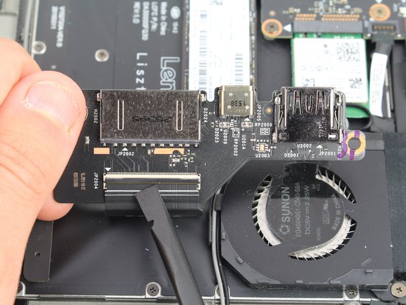

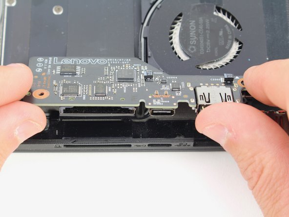

  7. Lenovo Yoga 900-13ISK Left Daughterboard Replacement: crwdns2935265:07crwdnd2935265:01crwdnd2935265:03crwdne2935265:0 Lenovo Yoga 900-13ISK Left Daughterboard Replacement: crwdns2935265:07crwdnd2935265:02crwdnd2935265:03crwdne2935265:0 Lenovo Yoga 900-13ISK Left Daughterboard Replacement: crwdns2935265:07crwdnd2935265:03crwdnd2935265:03crwdne2935265:0
    • Using a spudger, flip up the hinged locking tab of the ZIF connector on the underside of the daughterboard.
    • Pull the daughterboard away from the cable to disconnect.
