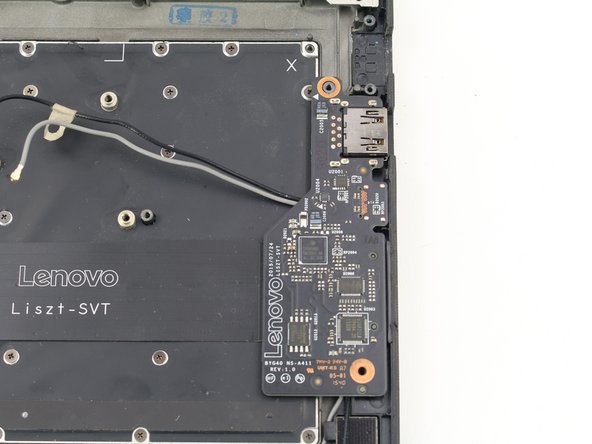

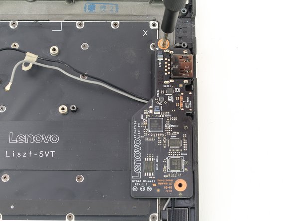

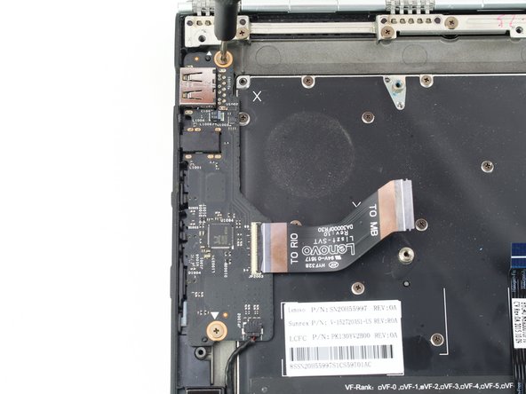

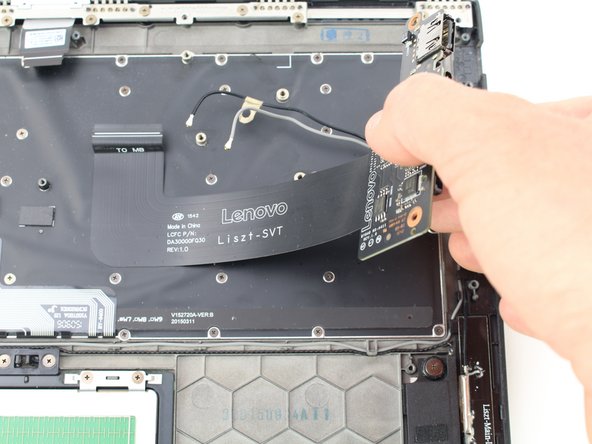

  19. Lenovo Yoga 900-13ISK Keyboard Replacement, Keyboard: crwdns2935265:019crwdnd2935265:01crwdnd2935265:03crwdne2935265:0 Lenovo Yoga 900-13ISK Keyboard Replacement, Keyboard: crwdns2935265:019crwdnd2935265:02crwdnd2935265:03crwdne2935265:0 Lenovo Yoga 900-13ISK Keyboard Replacement, Keyboard: crwdns2935265:019crwdnd2935265:03crwdnd2935265:03crwdne2935265:0
    • Remove the 3.6 mm screw from the daughterboard on the right with a Phillips #00 screwdriver.

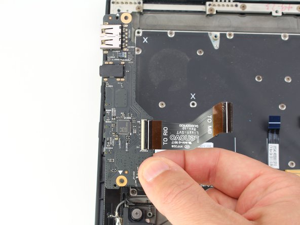

  20. Lenovo Yoga 900-13ISK Keyboard Replacement: crwdns2935265:020crwdnd2935265:01crwdnd2935265:03crwdne2935265:0 Lenovo Yoga 900-13ISK Keyboard Replacement: crwdns2935265:020crwdnd2935265:02crwdnd2935265:03crwdne2935265:0 Lenovo Yoga 900-13ISK Keyboard Replacement: crwdns2935265:020crwdnd2935265:03crwdnd2935265:03crwdne2935265:0
    • Lift the daughterboard from the right edge and peel off the interconnect cable from the keyboard panel.
  21. Lenovo Yoga 900-13ISK Keyboard Replacement: crwdns2935265:021crwdnd2935265:01crwdnd2935265:03crwdne2935265:0 Lenovo Yoga 900-13ISK Keyboard Replacement: crwdns2935265:021crwdnd2935265:02crwdnd2935265:03crwdne2935265:0 Lenovo Yoga 900-13ISK Keyboard Replacement: crwdns2935265:021crwdnd2935265:03crwdnd2935265:03crwdne2935265:0

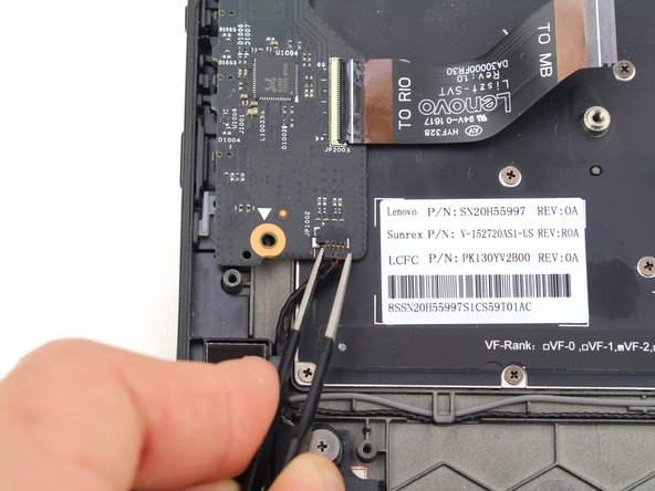

    • Use a Phillips #00 screwdriver to remove the two 3.6 mm screws from the daughterboard on the left.
  22. Lenovo Yoga 900-13ISK Keyboard Replacement: crwdns2935265:022crwdnd2935265:01crwdnd2935265:03crwdne2935265:0 Lenovo Yoga 900-13ISK Keyboard Replacement: crwdns2935265:022crwdnd2935265:02crwdnd2935265:03crwdne2935265:0 Lenovo Yoga 900-13ISK Keyboard Replacement: crwdns2935265:022crwdnd2935265:03crwdnd2935265:03crwdne2935265:0
    • Use a pair of blunt nose tweezers to pull out the speaker cable on the lower portion of the daughterboard.

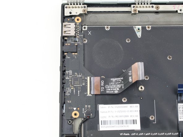

  23. Lenovo Yoga 900-13ISK Keyboard Replacement: crwdns2935265:023crwdnd2935265:01crwdnd2935265:02crwdne2935265:0 Lenovo Yoga 900-13ISK Keyboard Replacement: crwdns2935265:023crwdnd2935265:02crwdnd2935265:02crwdne2935265:0
    • Lift up the daughterboard from the right side to remove it from the case.

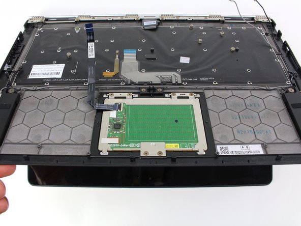

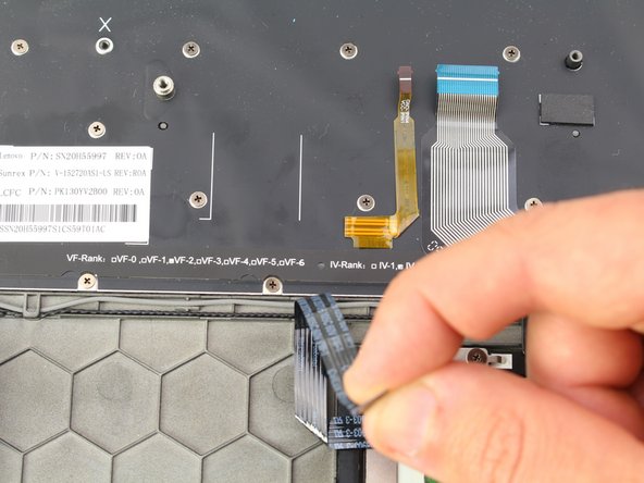

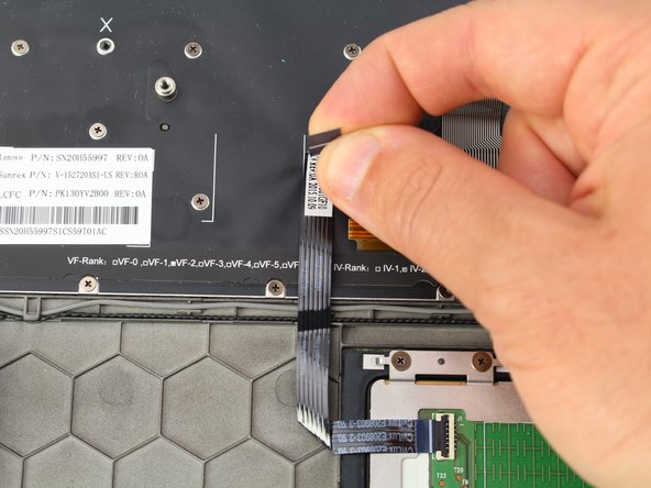

  24. Lenovo Yoga 900-13ISK Keyboard Replacement: crwdns2935265:024crwdnd2935265:01crwdnd2935265:03crwdne2935265:0 Lenovo Yoga 900-13ISK Keyboard Replacement: crwdns2935265:024crwdnd2935265:02crwdnd2935265:03crwdne2935265:0 Lenovo Yoga 900-13ISK Keyboard Replacement: crwdns2935265:024crwdnd2935265:03crwdnd2935265:03crwdne2935265:0
    • Peel back the trackpad cable from the black keyboard panel.

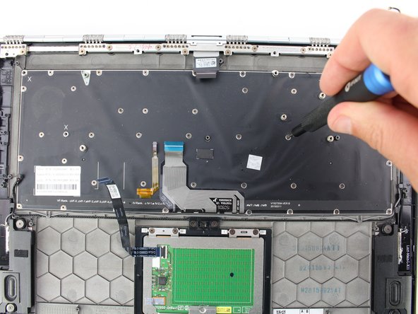

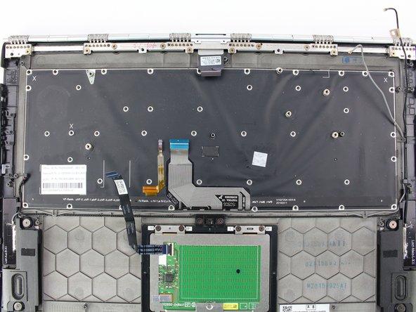

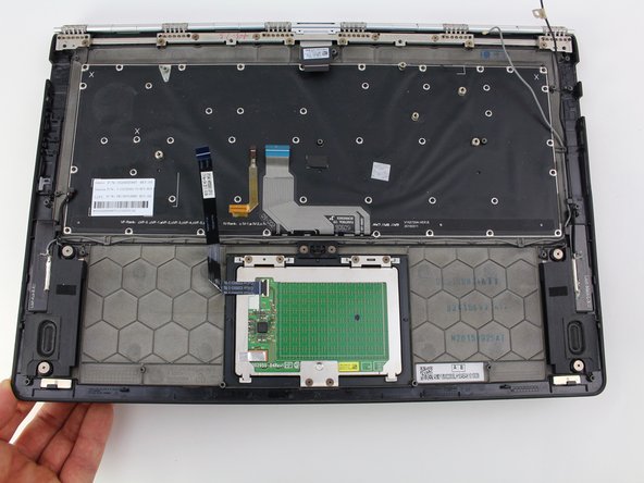

  25. Lenovo Yoga 900-13ISK Keyboard Replacement: crwdns2935265:025crwdnd2935265:01crwdnd2935265:03crwdne2935265:0 Lenovo Yoga 900-13ISK Keyboard Replacement: crwdns2935265:025crwdnd2935265:02crwdnd2935265:03crwdne2935265:0 Lenovo Yoga 900-13ISK Keyboard Replacement: crwdns2935265:025crwdnd2935265:03crwdnd2935265:03crwdne2935265:0
    • Remove the forty-one 1.9 mm screws from the keyboard panel with a Phillips #000 screwdriver.
    • While reassembling, you can use the 'X' markings to tell which holes do not need screws.
  26. Lenovo Yoga 900-13ISK Keyboard Replacement: crwdns2935265:026crwdnd2935265:01crwdnd2935265:03crwdne2935265:0 Lenovo Yoga 900-13ISK Keyboard Replacement: crwdns2935265:026crwdnd2935265:02crwdnd2935265:03crwdne2935265:0 Lenovo Yoga 900-13ISK Keyboard Replacement: crwdns2935265:026crwdnd2935265:03crwdnd2935265:03crwdne2935265:0

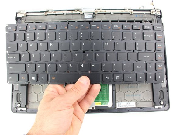

    • Open the laptop slightly.
  27. Lenovo Yoga 900-13ISK Keyboard Replacement: crwdns2935265:027crwdnd2935265:01crwdnd2935265:03crwdne2935265:0 Lenovo Yoga 900-13ISK Keyboard Replacement: crwdns2935265:027crwdnd2935265:02crwdnd2935265:03crwdne2935265:0 Lenovo Yoga 900-13ISK Keyboard Replacement: crwdns2935265:027crwdnd2935265:03crwdnd2935265:03crwdne2935265:0
    • Press the keyboard up from the underside and grab it to remove it from the case.
