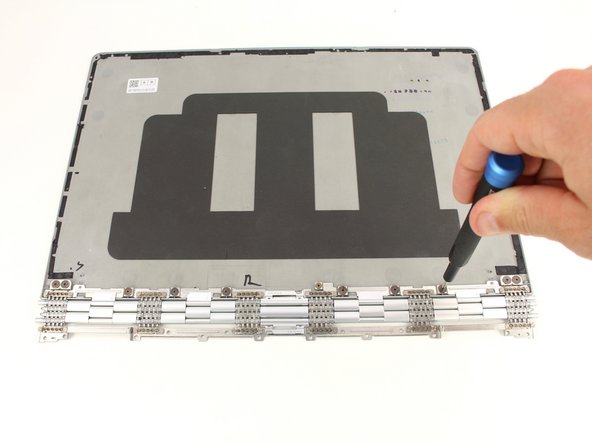

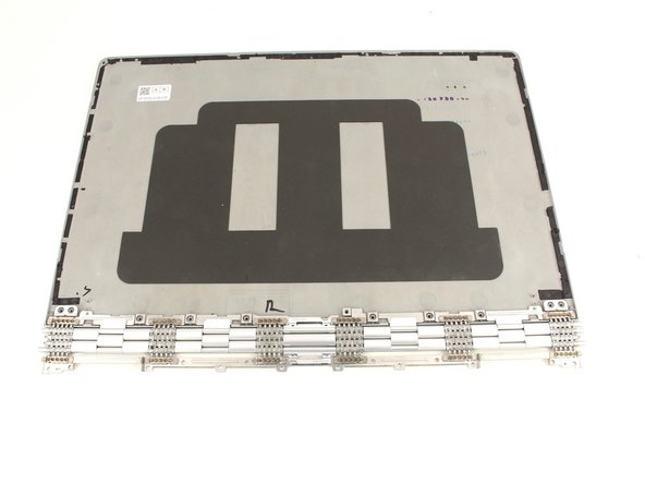

  17. Lenovo Yoga 900-13ISK Hinge Assembly Replacement, Hinge Assembly: crwdns2935265:017crwdnd2935265:01crwdnd2935265:03crwdne2935265:0 Lenovo Yoga 900-13ISK Hinge Assembly Replacement, Hinge Assembly: crwdns2935265:017crwdnd2935265:02crwdnd2935265:03crwdne2935265:0 Lenovo Yoga 900-13ISK Hinge Assembly Replacement, Hinge Assembly: crwdns2935265:017crwdnd2935265:03crwdnd2935265:03crwdne2935265:0
    • Remove the ten 2.3 mm screws from the hinge assembly with a Phillips #00 screwdriver.
    • Remove the single 2.2 mm screw from the hinge assembly with a Phillips #00 screwdriver.
    • This screw has a smaller head from the rest if you have trouble distinguishing it from the rest during reassembly.
  18. Lenovo Yoga 900-13ISK Hinge Assembly Replacement: crwdns2935265:018crwdnd2935265:01crwdnd2935265:01crwdne2935265:0
    • Lift off the hinge assembly.
