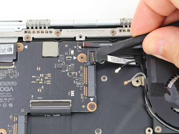

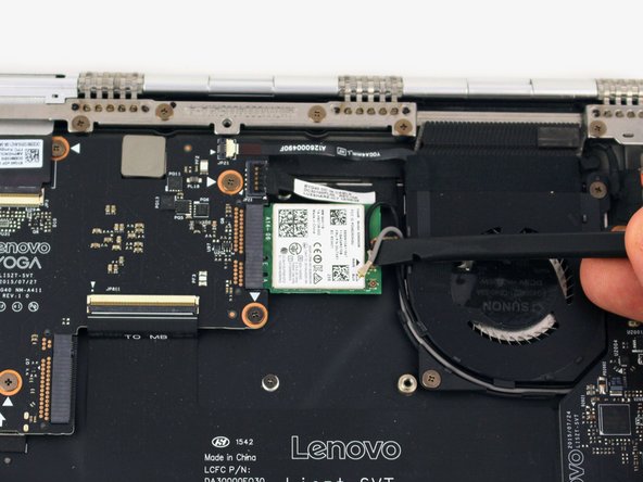

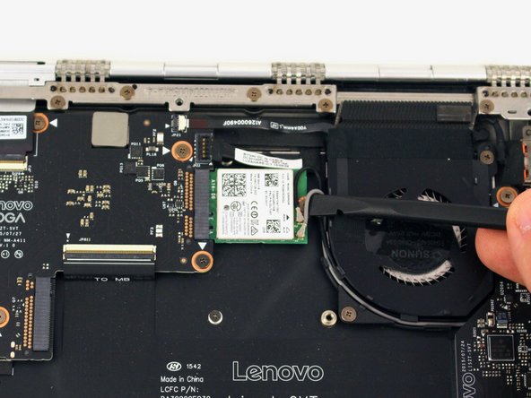

  7. Lenovo Yoga 900-13ISK Fan Assembly Replacement, Wi-Fi Card Prereq: crwdns2935265:07crwdnd2935265:01crwdnd2935265:03crwdne2935265:0 Lenovo Yoga 900-13ISK Fan Assembly Replacement, Wi-Fi Card Prereq: crwdns2935265:07crwdnd2935265:02crwdnd2935265:03crwdne2935265:0 Lenovo Yoga 900-13ISK Fan Assembly Replacement, Wi-Fi Card Prereq: crwdns2935265:07crwdnd2935265:03crwdnd2935265:03crwdne2935265:0
    • Pry up the gray and black coaxial cables from the Wi-Fi card using a spudger.
    • Move the cables to the side.

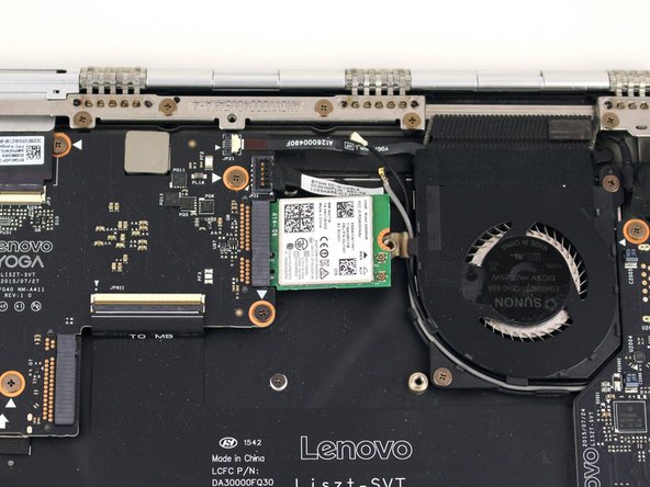

  8. Lenovo Yoga 900-13ISK Fan Assembly Replacement: crwdns2935265:08crwdnd2935265:01crwdnd2935265:03crwdne2935265:0 Lenovo Yoga 900-13ISK Fan Assembly Replacement: crwdns2935265:08crwdnd2935265:02crwdnd2935265:03crwdne2935265:0 Lenovo Yoga 900-13ISK Fan Assembly Replacement: crwdns2935265:08crwdnd2935265:03crwdnd2935265:03crwdne2935265:0
    • Using a Phillips #00 screwdriver, remove the 2.2 mm screw holding down the Wi-Fi card.
    • The Wi-Fi card may pop up to rest at an angle to the motherboard after the screw is removed.

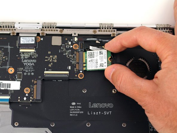

  9. Lenovo Yoga 900-13ISK Fan Assembly Replacement: crwdns2935265:09crwdnd2935265:01crwdnd2935265:03crwdne2935265:0 Lenovo Yoga 900-13ISK Fan Assembly Replacement: crwdns2935265:09crwdnd2935265:02crwdnd2935265:03crwdne2935265:0 Lenovo Yoga 900-13ISK Fan Assembly Replacement: crwdns2935265:09crwdnd2935265:03crwdnd2935265:03crwdne2935265:0
    • Pull the WiFi card out from the connector on the motherboard.

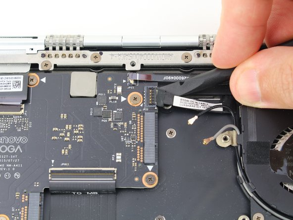

  10. Lenovo Yoga 900-13ISK Fan Assembly Replacement, Motherboard: crwdns2935265:010crwdnd2935265:01crwdnd2935265:03crwdne2935265:0 Lenovo Yoga 900-13ISK Fan Assembly Replacement, Motherboard: crwdns2935265:010crwdnd2935265:02crwdnd2935265:03crwdne2935265:0 Lenovo Yoga 900-13ISK Fan Assembly Replacement, Motherboard: crwdns2935265:010crwdnd2935265:03crwdnd2935265:03crwdne2935265:0
    • Using the pointed end of a spudger, flip up the hinged locking tabs of the eight ZIF connectors on the motherboard.
    • Pull the eight cables out from their connectors using a pair of blunt nose tweezers.

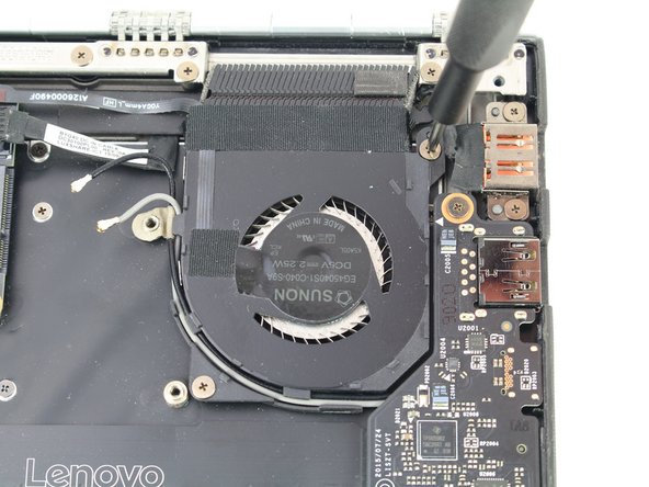

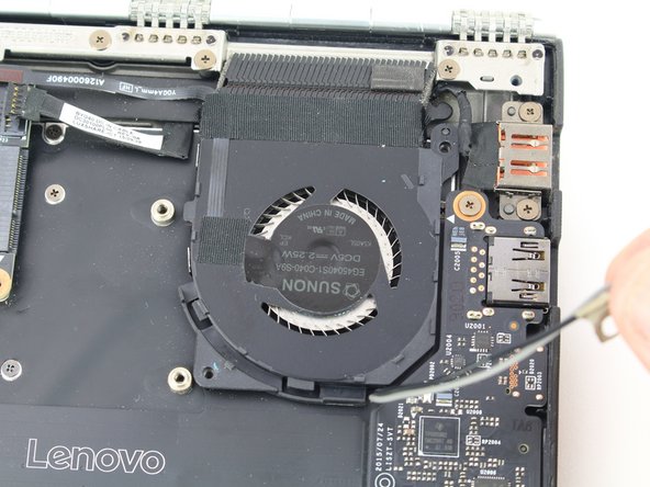

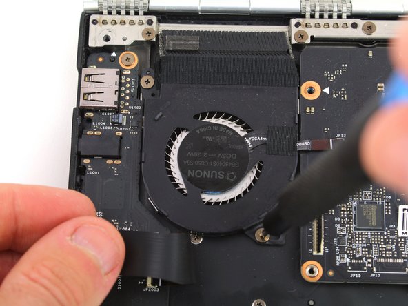

    • Pull back the interconnect cable on the left side of the motherboard to reveal one of the fan screws for the left fan.
    • Remove the two 3.6 mm screws from the left fan with a Phillips #00 screwdriver.

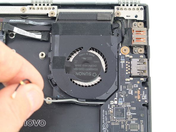

  14. Lenovo Yoga 900-13ISK Fan Assembly Replacement: crwdns2935265:014crwdnd2935265:01crwdnd2935265:03crwdne2935265:0 Lenovo Yoga 900-13ISK Fan Assembly Replacement: crwdns2935265:014crwdnd2935265:02crwdnd2935265:03crwdne2935265:0 Lenovo Yoga 900-13ISK Fan Assembly Replacement: crwdns2935265:014crwdnd2935265:03crwdnd2935265:03crwdne2935265:0

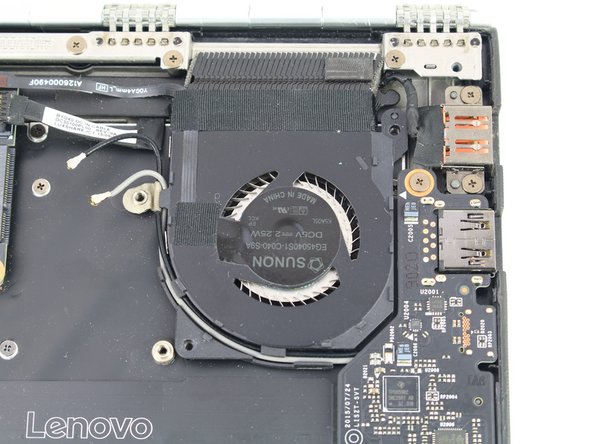

    • Remove the two 3.6 mm screws from the right fan using a Phillips #00 screwdriver.
  15. Lenovo Yoga 900-13ISK Fan Assembly Replacement: crwdns2935265:015crwdnd2935265:01crwdnd2935265:03crwdne2935265:0 Lenovo Yoga 900-13ISK Fan Assembly Replacement: crwdns2935265:015crwdnd2935265:02crwdnd2935265:03crwdne2935265:0 Lenovo Yoga 900-13ISK Fan Assembly Replacement: crwdns2935265:015crwdnd2935265:03crwdnd2935265:03crwdne2935265:0
    • Unwind the black and white coaxial cables from the hooks on the right fan casing.

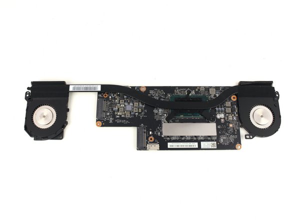

    • Lift the motherboard from the bottom edge and pull it up and out of the case.
    • If you need to remove the fan assembly to swap it over to your new motherboard, continue to follow along with the heatsink guide.
  17. Lenovo Yoga 900-13ISK Fan Assembly Replacement, Fan Assembly: crwdns2935265:017crwdnd2935265:01crwdnd2935265:02crwdne2935265:0 Lenovo Yoga 900-13ISK Fan Assembly Replacement, Fan Assembly: crwdns2935265:017crwdnd2935265:02crwdnd2935265:02crwdne2935265:0

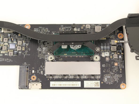

    • Flip the motherboard over to access the heatsink.

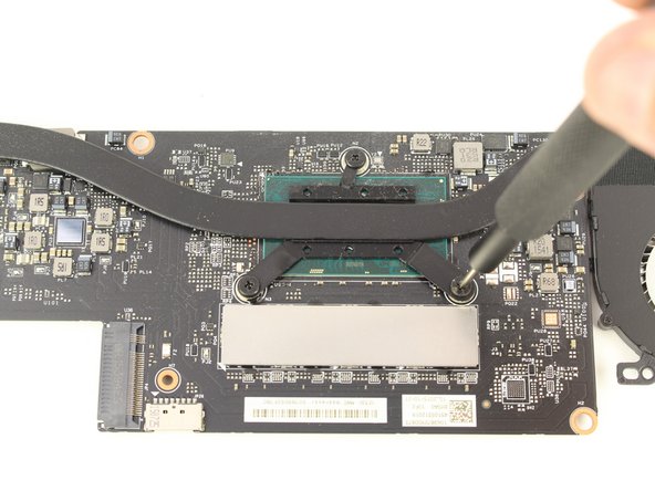

  18. Lenovo Yoga 900-13ISK Fan Assembly Replacement: crwdns2935265:018crwdnd2935265:01crwdnd2935265:03crwdne2935265:0 Lenovo Yoga 900-13ISK Fan Assembly Replacement: crwdns2935265:018crwdnd2935265:02crwdnd2935265:03crwdne2935265:0 Lenovo Yoga 900-13ISK Fan Assembly Replacement: crwdns2935265:018crwdnd2935265:03crwdnd2935265:03crwdne2935265:0
    • Unscrew the three captive screws on the heatsink with a Phillips #1 screwdriver.
    • These screws can be very tight, so be sure to employ screwdriver best practices and apply a lot of downward force to avoid stripping the screws.
  19. Lenovo Yoga 900-13ISK Fan Assembly Replacement: crwdns2935265:019crwdnd2935265:01crwdnd2935265:01crwdne2935265:0
    • Lift the heatsink and fan assembly off of the motherboard.
    • Be sure to clean off the old thermal paste and replace it with a fresh application any time the heatsink is separated from the CPU. Check out our How to Apply Thermal Paste guide if you need help!
