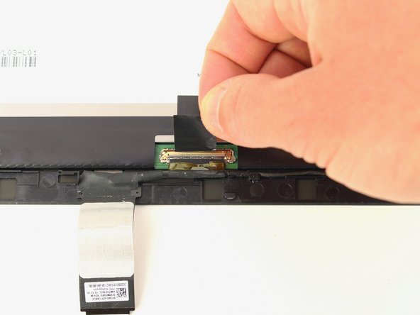

  17. Lenovo Yoga 900-13ISK Display Replacement, Display: crwdns2935265:017crwdnd2935265:01crwdnd2935265:03crwdne2935265:0 Lenovo Yoga 900-13ISK Display Replacement, Display: crwdns2935265:017crwdnd2935265:02crwdnd2935265:03crwdne2935265:0 Lenovo Yoga 900-13ISK Display Replacement, Display: crwdns2935265:017crwdnd2935265:03crwdnd2935265:03crwdne2935265:0
    • Peel up the small strip of tape wrapped around the locking bar of the display cable connector.
  18. Lenovo Yoga 900-13ISK Display Replacement: crwdns2935265:018crwdnd2935265:01crwdnd2935265:02crwdne2935265:0 Lenovo Yoga 900-13ISK Display Replacement: crwdns2935265:018crwdnd2935265:02crwdnd2935265:02crwdne2935265:0
    • Pull the tape downward to unplug the display cable.

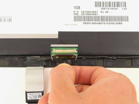

  19. Lenovo Yoga 900-13ISK Display Replacement: crwdns2935265:019crwdnd2935265:01crwdnd2935265:03crwdne2935265:0 Lenovo Yoga 900-13ISK Display Replacement: crwdns2935265:019crwdnd2935265:02crwdnd2935265:03crwdne2935265:0 Lenovo Yoga 900-13ISK Display Replacement: crwdns2935265:019crwdnd2935265:03crwdnd2935265:03crwdne2935265:0
    • Gently pull the cable out from the routing to free it from the hooks along the edge of the screen.

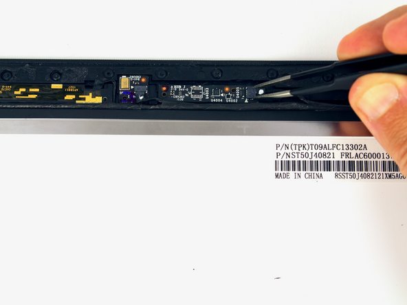

  20. Lenovo Yoga 900-13ISK Display Replacement: crwdns2935265:020crwdnd2935265:01crwdnd2935265:03crwdne2935265:0 Lenovo Yoga 900-13ISK Display Replacement: crwdns2935265:020crwdnd2935265:02crwdnd2935265:03crwdne2935265:0 Lenovo Yoga 900-13ISK Display Replacement: crwdns2935265:020crwdnd2935265:03crwdnd2935265:03crwdne2935265:0
    • Gently unplug the five cables on the control boards on the top edge of the display with a pair of blunt nose tweezers.
    • Be extremely cautious as you handle these cables, as they are easily broken. If the pair of tweezers doesn't work for you, you can gently wiggle the cables back and forth with your fingers to ease them out from the connectors.
    • Remove the display cable.

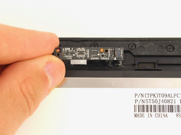

  21. Lenovo Yoga 900-13ISK Display Replacement: crwdns2935265:021crwdnd2935265:01crwdnd2935265:03crwdne2935265:0 Lenovo Yoga 900-13ISK Display Replacement: crwdns2935265:021crwdnd2935265:02crwdnd2935265:03crwdne2935265:0 Lenovo Yoga 900-13ISK Display Replacement: crwdns2935265:021crwdnd2935265:03crwdnd2935265:03crwdne2935265:0
    • Gently pry up any of the boards that are missing from your new display with a nylon spudger and put them in the same place on the new display.
    • Emphasis on the 'gently'—we had two of these boards snap or bend significantly while trying to get them off. Be particularly cautious when prying up the yellow-accented webcam board in the center, as the adhesive is quite strong.
    • The touch control board on the far left is wired into the digitizer and cannot be removed. Your new display should come with this board already in place.
