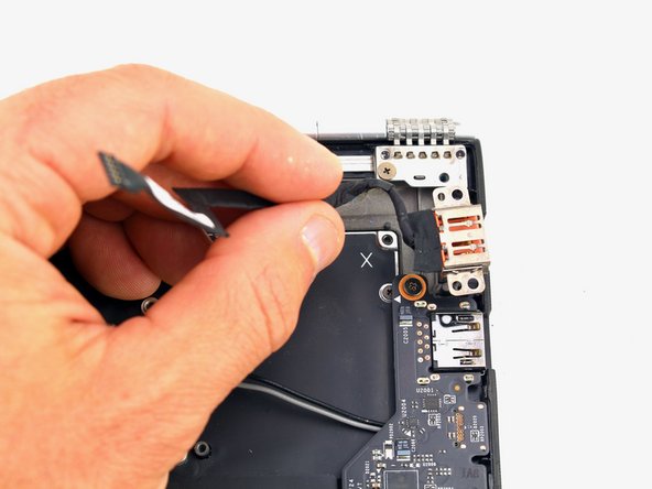

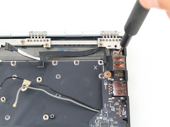

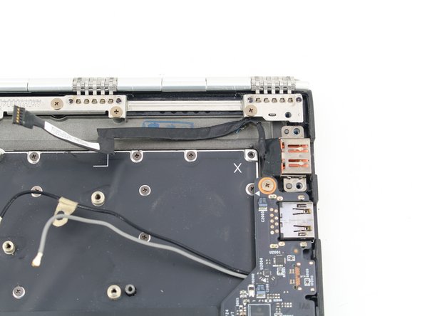

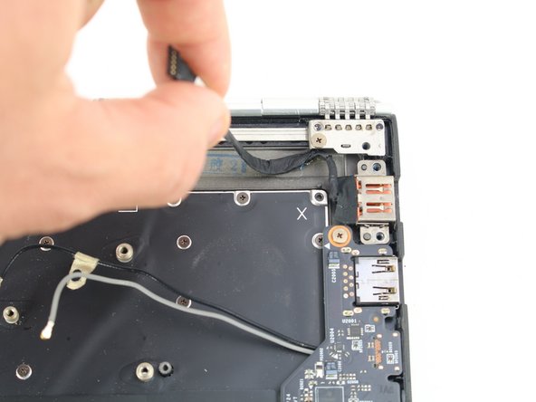

  17. Lenovo Yoga 900-13ISK Charging Port Replacement, Charging Port: crwdns2935265:017crwdnd2935265:01crwdnd2935265:03crwdne2935265:0 Lenovo Yoga 900-13ISK Charging Port Replacement, Charging Port: crwdns2935265:017crwdnd2935265:02crwdnd2935265:03crwdne2935265:0 Lenovo Yoga 900-13ISK Charging Port Replacement, Charging Port: crwdns2935265:017crwdnd2935265:03crwdnd2935265:03crwdne2935265:0
    • Remove the two 3.5 mm screws from the charging port with a Phillips #00 screwdriver.
  18. Lenovo Yoga 900-13ISK Charging Port Replacement: crwdns2935265:018crwdnd2935265:01crwdnd2935265:03crwdne2935265:0 Lenovo Yoga 900-13ISK Charging Port Replacement: crwdns2935265:018crwdnd2935265:02crwdnd2935265:03crwdne2935265:0 Lenovo Yoga 900-13ISK Charging Port Replacement: crwdns2935265:018crwdnd2935265:03crwdnd2935265:03crwdne2935265:0
    • Peel up the charging port cable and remove the charging port.

Why did you have to remove the motherboard and all of its connections to replace the DC in cable? Couldn’t you have just removed the fan to get access to the DC in cable?
Chris - crwdns2934203:0crwdne2934203:0
Bruh, why don't you show how to reconnect the charging port? That's what I am stuck on. It looked easy and now I can't get it back in.
