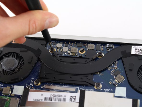

  7. Lenovo Yoga 730-13IKB Touchscreen Display  Replacement, Heat Sink: crwdns2935265:07crwdnd2935265:01crwdnd2935265:02crwdne2935265:0 Lenovo Yoga 730-13IKB Touchscreen Display  Replacement, Heat Sink: crwdns2935265:07crwdnd2935265:02crwdnd2935265:02crwdne2935265:0
    • Use a Phillips #00 screwdriver to remove the eight 2.5mm screws securing the heat sink assembly.

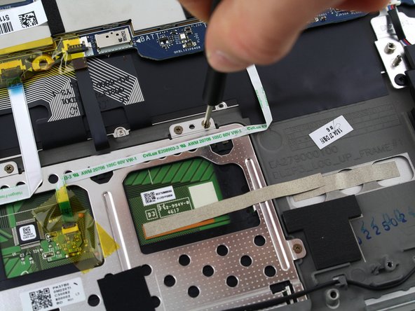

  10. Lenovo Yoga 730-13IKB Touchscreen Display  Replacement, Touchpad: crwdns2935265:010crwdnd2935265:01crwdnd2935265:02crwdne2935265:0 Lenovo Yoga 730-13IKB Touchscreen Display  Replacement, Touchpad: crwdns2935265:010crwdnd2935265:02crwdnd2935265:02crwdne2935265:0
    • Use a Phillips #00 screwdriver to remove the six 2.5mm screws holding down the touch pad.

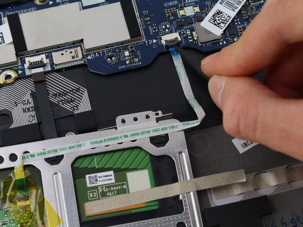

  14. Lenovo Yoga 730-13IKB Touchscreen Display  Replacement: crwdns2935265:014crwdnd2935265:01crwdnd2935265:03crwdne2935265:0 Lenovo Yoga 730-13IKB Touchscreen Display  Replacement: crwdns2935265:014crwdnd2935265:02crwdnd2935265:03crwdne2935265:0 Lenovo Yoga 730-13IKB Touchscreen Display  Replacement: crwdns2935265:014crwdnd2935265:03crwdnd2935265:03crwdne2935265:0
    • Peel the yellow tape off of the touchpad connector.
    • Gently push the gray tab up on the connector using a spudger. Pull out the cable.

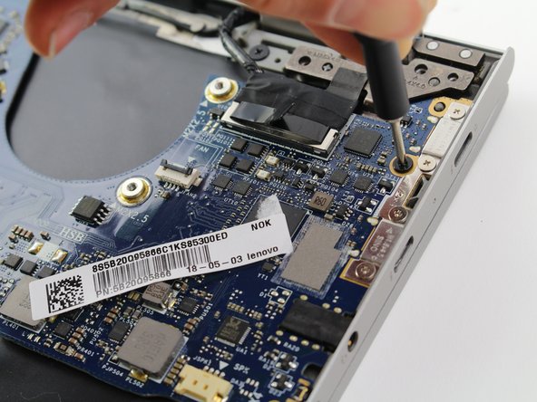

  16. Lenovo Yoga 730-13IKB Touchscreen Display  Replacement, Motherboard: crwdns2935265:016crwdnd2935265:01crwdnd2935265:02crwdne2935265:0 Lenovo Yoga 730-13IKB Touchscreen Display  Replacement, Motherboard: crwdns2935265:016crwdnd2935265:02crwdnd2935265:02crwdne2935265:0
    • Use a Phillips #00 screwdriver to remove the five 3.5mm screws securing the motherboard.
  17. Lenovo Yoga 730-13IKB Touchscreen Display  Replacement: crwdns2935265:017crwdnd2935265:01crwdnd2935265:01crwdne2935265:0
    • Use a Phillips #000 driver to remove the four 3mm screws holding down the connector bracket.
  18. Lenovo Yoga 730-13IKB Touchscreen Display  Replacement: crwdns2935265:018crwdnd2935265:01crwdnd2935265:01crwdne2935265:0
    • Lift the bracket up from the motherboard and place aside.

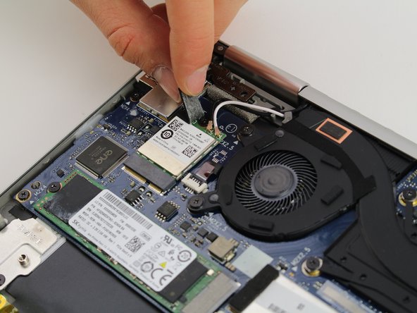

  22. Lenovo Yoga 730-13IKB Touchscreen Display  Replacement: crwdns2935265:022crwdnd2935265:01crwdnd2935265:02crwdne2935265:0 Lenovo Yoga 730-13IKB Touchscreen Display  Replacement: crwdns2935265:022crwdnd2935265:02crwdnd2935265:02crwdne2935265:0
    • Peel the black adhesive strip covering the wires to the LAN card.
    • Keep the adhesive strip for when you reconnect the LAN card.
  23. Lenovo Yoga 730-13IKB Touchscreen Display  Replacement: crwdns2935265:023crwdnd2935265:01crwdnd2935265:01crwdne2935265:0

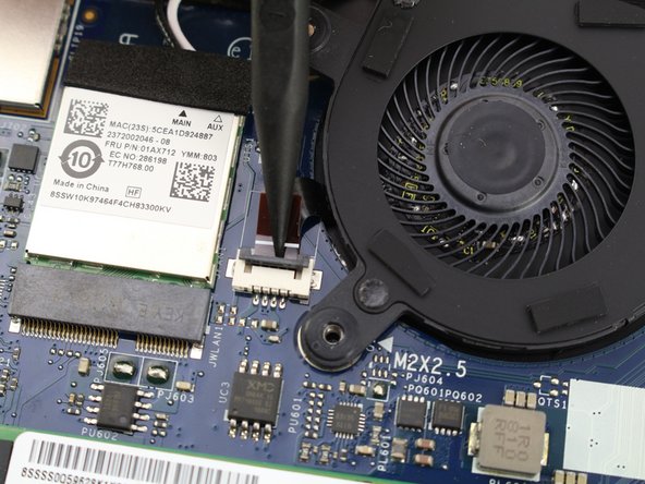

    • Use a Phillips #00 screwdriver to remove the 2.5mm screw securing the LAN card.

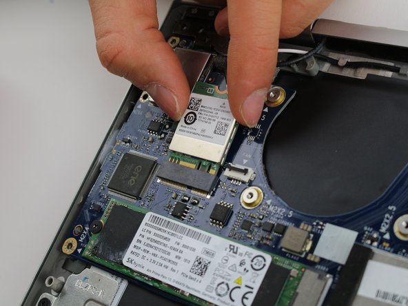

  24. Lenovo Yoga 730-13IKB Touchscreen Display  Replacement: crwdns2935265:024crwdnd2935265:01crwdnd2935265:02crwdne2935265:0 Lenovo Yoga 730-13IKB Touchscreen Display  Replacement: crwdns2935265:024crwdnd2935265:02crwdnd2935265:02crwdne2935265:0
    • Gently slide the LAN card straight out of the motherboard connector.
  25. Lenovo Yoga 730-13IKB Touchscreen Display  Replacement: crwdns2935265:025crwdnd2935265:01crwdnd2935265:01crwdne2935265:0
    • Disconnect the black and white wires from the LAN card.
    • The black and white wires attach to the LAN card using a button-style clasp.
    • To reinstall the wires on the LAN card, push down on the wire connector until it clicks.

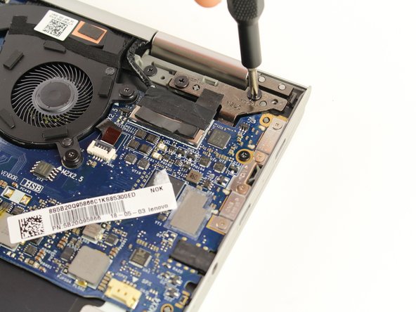

  29. Lenovo Yoga 730-13IKB Touchscreen Display  Replacement, Touchscreen Display: crwdns2935265:029crwdnd2935265:01crwdnd2935265:02crwdne2935265:0 Lenovo Yoga 730-13IKB Touchscreen Display  Replacement, Touchscreen Display: crwdns2935265:029crwdnd2935265:02crwdnd2935265:02crwdne2935265:0
    • Use a Phillips #00 screwdriver to remove the four 4mm display hinge screws.

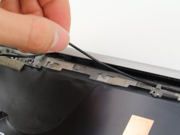

  30. Lenovo Yoga 730-13IKB Touchscreen Display  Replacement: crwdns2935265:030crwdnd2935265:01crwdnd2935265:03crwdne2935265:0 Lenovo Yoga 730-13IKB Touchscreen Display  Replacement: crwdns2935265:030crwdnd2935265:02crwdnd2935265:03crwdne2935265:0 Lenovo Yoga 730-13IKB Touchscreen Display  Replacement: crwdns2935265:030crwdnd2935265:03crwdnd2935265:03crwdne2935265:0
    • Rotate the screen hinge next to the LAN card away from the laptop frame.
    • Pull the black LAN card wire through the hinge and unhook it from the holding tabs.

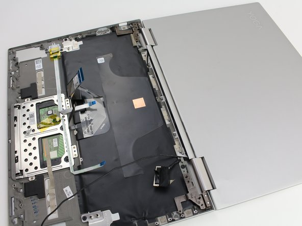

  32. Lenovo Yoga 730-13IKB Touchscreen Display  Replacement: crwdns2935265:032crwdnd2935265:01crwdnd2935265:01crwdne2935265:0
    • Lift the touchscreen back and up to unhook the hinges from the laptop frame.
