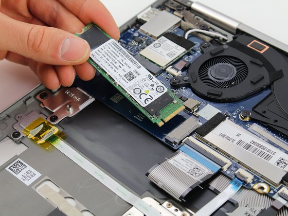

  4. Lenovo Yoga 730-13IKB Storage Replacement, Storage: crwdns2935265:04crwdnd2935265:01crwdnd2935265:01crwdne2935265:0
    • Use a Phillips #00 screwdriver to remove the 4mm screw holding down the storage drive.
  5. Lenovo Yoga 730-13IKB Storage Replacement: crwdns2935265:05crwdnd2935265:01crwdnd2935265:02crwdne2935265:0 Lenovo Yoga 730-13IKB Storage Replacement: crwdns2935265:05crwdnd2935265:02crwdnd2935265:02crwdne2935265:0
    • Hold onto the back of the storage drive and slightly lift up.
    • Remove the drive by pulling back at a diagonal angle.
    • To install the storage drive, insert it into the connector at a slight downwards angle. The drive connector is keyed and will only go in one way.
