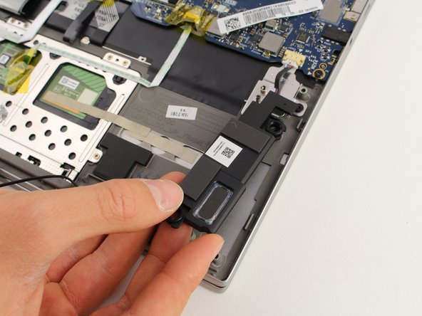

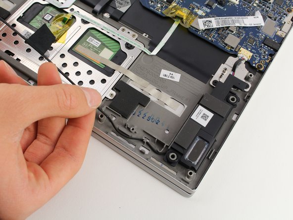

  7. Lenovo Yoga 730-13IKB Speaker Replacement, Speaker: crwdns2935265:07crwdnd2935265:01crwdnd2935265:02crwdne2935265:0 Lenovo Yoga 730-13IKB Speaker Replacement, Speaker: crwdns2935265:07crwdnd2935265:02crwdnd2935265:02crwdne2935265:0
    • Lift the left speaker module straight off its screw-less mount.
    • Both speaker modules are mounted with rubber spacers instead of screws. Removal and installation is done by hand.

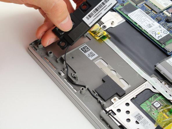

  8. Lenovo Yoga 730-13IKB Speaker Replacement: crwdns2935265:08crwdnd2935265:01crwdnd2935265:02crwdne2935265:0 Lenovo Yoga 730-13IKB Speaker Replacement: crwdns2935265:08crwdnd2935265:02crwdnd2935265:02crwdne2935265:0
    • Pull the speaker wire out from the plastic hooks on the laptop frame.
    • Pay close attention to the wire routing when removing the speaker for successful reinstallation. The wire should be secure in the hooks but not overly tight.

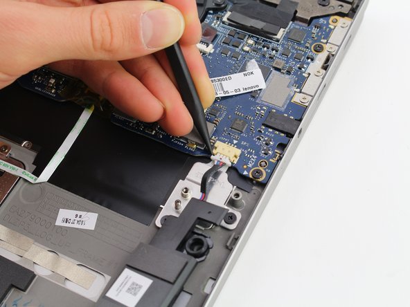

  9. Lenovo Yoga 730-13IKB Speaker Replacement: crwdns2935265:09crwdnd2935265:01crwdnd2935265:03crwdne2935265:0 Lenovo Yoga 730-13IKB Speaker Replacement: crwdns2935265:09crwdnd2935265:02crwdnd2935265:03crwdne2935265:0 Lenovo Yoga 730-13IKB Speaker Replacement: crwdns2935265:09crwdnd2935265:03crwdnd2935265:03crwdne2935265:0
    • Hold the white speaker connector with a finger and a spudger. Pull straight back to disconnect the speaker cable.
    • Lift the right speaker module straight up from its mount.
    • The speaker connector does not lock but requires moderate force to disconnect.
