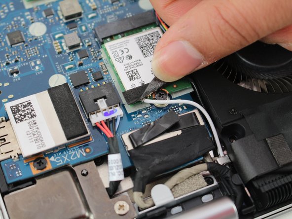

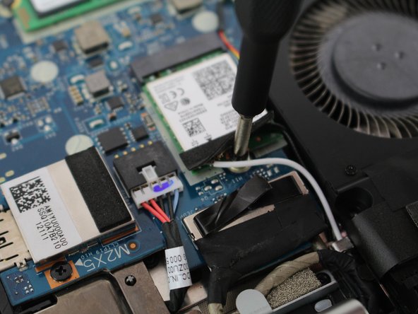

  3. Lenovo Yoga 720-15IKB Wireless Adapter Replacement, Wireless Adapter: crwdns2935265:03crwdnd2935265:01crwdnd2935265:03crwdne2935265:0 Lenovo Yoga 720-15IKB Wireless Adapter Replacement, Wireless Adapter: crwdns2935265:03crwdnd2935265:02crwdnd2935265:03crwdne2935265:0 Lenovo Yoga 720-15IKB Wireless Adapter Replacement, Wireless Adapter: crwdns2935265:03crwdnd2935265:03crwdnd2935265:03crwdne2935265:0
    • Lift the foam covering the connecting wires and screw, and use the Phillips #0 screwdriver to remove the 2mm screw.
  4. Lenovo Yoga 720-15IKB Wireless Adapter Replacement: crwdns2935265:04crwdnd2935265:01crwdnd2935265:01crwdne2935265:0
    • Grab the adapter from both sides and pull towards the hinge to remove the adapter from the device.
  5. Lenovo Yoga 720-15IKB Wireless Adapter Replacement: crwdns2935265:05crwdnd2935265:01crwdnd2935265:01crwdne2935265:0
    • Remove the black and white wires from the adapter by pulling up on each wire.
    • When reassembling, make sure to press each wire connector firmly onto the new adapter to make sure it is a secure fit.
