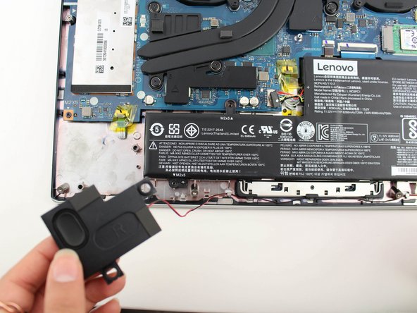

  3. Lenovo Yoga 720-15IKB Speakers Replacement, Speakers: crwdns2935265:03crwdnd2935265:01crwdnd2935265:03crwdne2935265:0 Lenovo Yoga 720-15IKB Speakers Replacement, Speakers: crwdns2935265:03crwdnd2935265:02crwdnd2935265:03crwdne2935265:0 Lenovo Yoga 720-15IKB Speakers Replacement, Speakers: crwdns2935265:03crwdnd2935265:03crwdnd2935265:03crwdne2935265:0
    • Here are the speakers for this device.
    • Pull the right speaker straight up and remove it from the computer.
    • As you remove the speaker, make sure to also carefully pull the wire connected to the speaker out along with the speaker.
  4. Lenovo Yoga 720-15IKB Speakers Replacement: crwdns2935265:04crwdnd2935265:01crwdnd2935265:01crwdne2935265:0
    • Remove the left speaker similarly to how the right speaker was removed.
  5. Lenovo Yoga 720-15IKB Speakers Replacement: crwdns2935265:05crwdnd2935265:01crwdnd2935265:01crwdne2935265:0
    • Unplug the speaker by firmly pulling the wire out of the socket.
