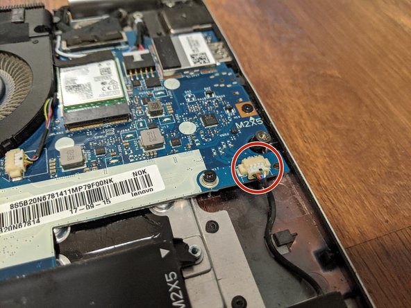

  4. Lenovo Yoga 720-15IKB Speaker Replacement, Unplug Speaker cable: crwdns2935265:05crwdnd2935265:01crwdnd2935265:02crwdne2935265:0 Lenovo Yoga 720-15IKB Speaker Replacement, Unplug Speaker cable: crwdns2935265:05crwdnd2935265:02crwdnd2935265:02crwdne2935265:0
    • Unplug the speaker cable.
