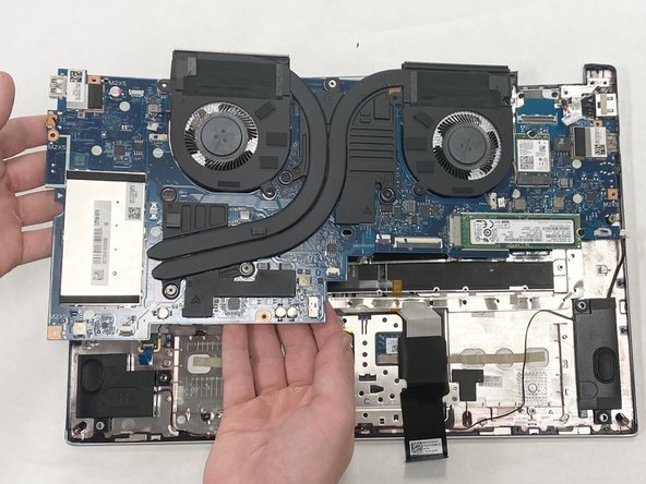

  8. Lenovo Yoga 720-15IKB Keyboard Replacement, Motherboard: crwdns2935265:08crwdnd2935265:01crwdnd2935265:01crwdne2935265:0
    • Using the Phillips #000 screwdriver, remove the five screws.
  9. Lenovo Yoga 720-15IKB Keyboard Replacement: crwdns2935265:09crwdnd2935265:01crwdnd2935265:02crwdne2935265:0 Lenovo Yoga 720-15IKB Keyboard Replacement: crwdns2935265:09crwdnd2935265:02crwdnd2935265:02crwdne2935265:0
    • Disconnect the power outlet connector.
    • Disconnect the speaker wire connector.
    • Carefully lift the motherboard up and out of the device.

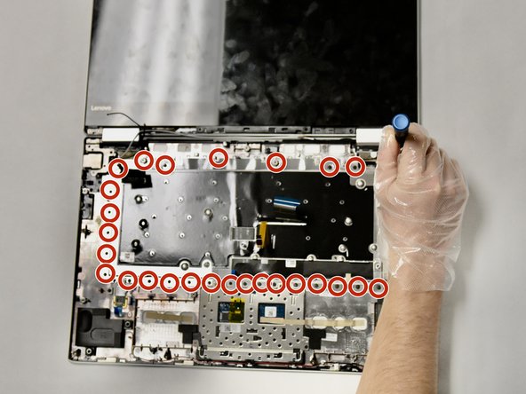

  10. Lenovo Yoga 720-15IKB Keyboard Replacement, Keyboard: crwdns2935265:010crwdnd2935265:01crwdnd2935265:02crwdne2935265:0 Lenovo Yoga 720-15IKB Keyboard Replacement, Keyboard: crwdns2935265:010crwdnd2935265:02crwdnd2935265:02crwdne2935265:0
    • Using the Phillips #000 screwdriver, remove the 39 welded screws holding the keyboard cover in place.
    • Gently lift to remove the keyboard cover.

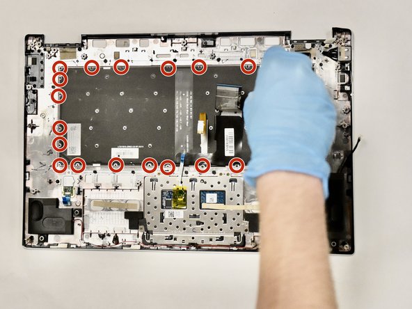

  11. Lenovo Yoga 720-15IKB Keyboard Replacement: crwdns2935265:011crwdnd2935265:01crwdnd2935265:02crwdne2935265:0 Lenovo Yoga 720-15IKB Keyboard Replacement: crwdns2935265:011crwdnd2935265:02crwdnd2935265:02crwdne2935265:0
    • Using the same Phillips #000 screwdriver, remove the 27 welded screws holding the keyboard in place.
    • Gently lift to remove the keyboard.

Hi, how did you remove the welded screws from the keyboard?
John Brown - crwdns2934203:0crwdne2934203:0
I agree with john brown, how did you manage to remove the welded screws from the keyboard?
Kareem Azzouz - crwdns2934203:0crwdne2934203:0
Yes, how did you remove the welded screws?
Florian - crwdns2934203:0crwdne2934203:0
This model of laptop is not designed to allow the keyboard to be removed. A very handy (or very lucky) person might be able to get the welded screws out, but they are not designed to be removed. Additionally, DO NOT REMOVE THE FAN! There are a couple of screws at the back of the fans that need to removed to remove the motherboard, but it is not necessary to remove the whole fan in order to remove the motherboard (and if you do, you would then need to re-seat the fan and mess with applying new thermal paste when doing so).
Stephen Engelhardt - crwdns2934203:0crwdne2934203:0
True that the "welded screws" are...... not really screws at all. We broke off the capped bits that hold the keyboard and cover in place. We then replaced the keyboard and used a glue-gun on each of the "screws" to keep them in place, effectively "repairing" each of the screws we had broken off (/ had "un-capped)".
This works like a charm. It was a few years ago, and I am using it still, including right now :)
Never saw such an insane design in a laptop before. It seemed a bit scary to break off dozens of bits in a laptop, but it wasn't in the end. Don't let this hold you back from repairing your (otherwise) awesome laptop!
