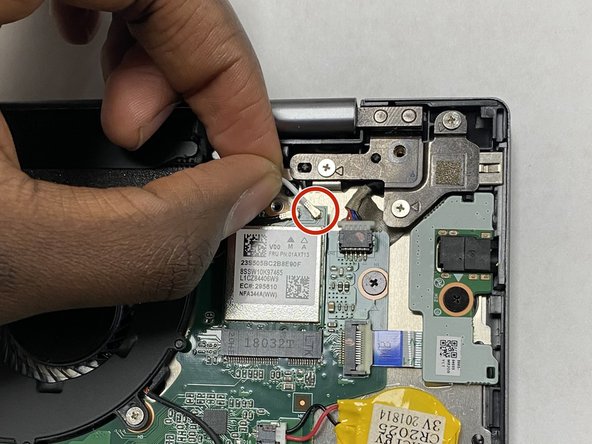

  6. Lenovo Yoga 720-12IKB Wireless LAN Card Replacement, Wireless LAN Card: crwdns2935265:06crwdnd2935265:01crwdnd2935265:01crwdne2935265:0
    • On the top right of the system you will find the wireless LAN card. Remove the 3.0 mm Phillips #00 screw.
  7. Lenovo Yoga 720-12IKB Wireless LAN Card Replacement: crwdns2935265:07crwdnd2935265:01crwdnd2935265:02crwdne2935265:0 Lenovo Yoga 720-12IKB Wireless LAN Card Replacement: crwdns2935265:07crwdnd2935265:02crwdnd2935265:02crwdne2935265:0
    • Disconnect both wireless LAN cables by pulling up.
  8. Lenovo Yoga 720-12IKB Wireless LAN Card Replacement: crwdns2935265:08crwdnd2935265:01crwdnd2935265:01crwdne2935265:0
    • Lift the wireless LAN card up and pull out.
  9. Lenovo Yoga 720-12IKB Wireless LAN Card Replacement: crwdns2935265:09crwdnd2935265:01crwdnd2935265:01crwdne2935265:0
    • You can now replace the wireless LAN card.
