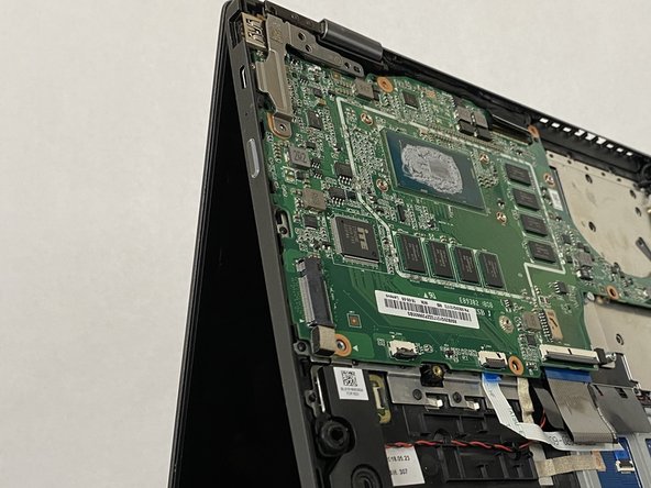

  6. Lenovo Yoga 720-12IKB Motherboard Replacement, Motherboard: crwdns2935265:06crwdnd2935265:01crwdnd2935265:01crwdne2935265:0
    • The motherboard is located above the battery.
  7. Lenovo Yoga 720-12IKB Motherboard Replacement: crwdns2935265:07crwdnd2935265:01crwdnd2935265:01crwdne2935265:0

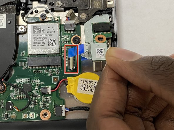

    • Unscrew and remove the 2.0 mm Phillips #00 screws.
  8. Lenovo Yoga 720-12IKB Motherboard Replacement: crwdns2935265:08crwdnd2935265:01crwdnd2935265:02crwdne2935265:0 Lenovo Yoga 720-12IKB Motherboard Replacement: crwdns2935265:08crwdnd2935265:02crwdnd2935265:02crwdne2935265:0
    • Disconnect the connectors by lifting up the clip and pulling them out.

  11. Lenovo Yoga 720-12IKB Motherboard Replacement: crwdns2935265:011crwdnd2935265:01crwdnd2935265:01crwdne2935265:0
    • Remove the motherboard after all screws are out and connectors are disconnected.
