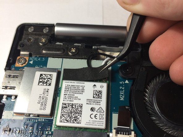

    • This is the wireless adapter.
    • Using tweezers, remove the fuzzy tape.

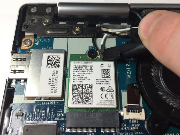

    • Remove the white and black antenna cables using a spudger.
    • Move any cables in the way out of the way.

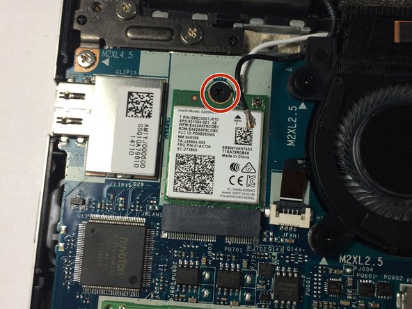

    • Remove one JIS1 screw holding the wireless card in place.
  8. Lenovo Yoga 720 Wireless Adapter Replacement: crwdns2935265:08crwdnd2935265:01crwdnd2935265:01crwdne2935265:0
    • Gently pull out the wireless card.
