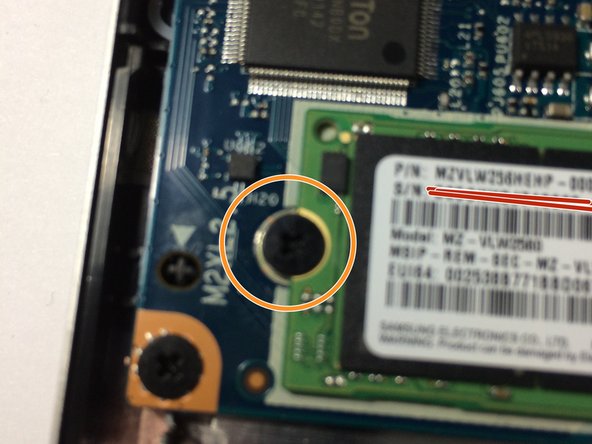

  6. Lenovo Yoga 720 SSD Replacement, SSD: crwdns2935265:06crwdnd2935265:01crwdnd2935265:03crwdne2935265:0 Lenovo Yoga 720 SSD Replacement, SSD: crwdns2935265:06crwdnd2935265:02crwdnd2935265:03crwdne2935265:0 Lenovo Yoga 720 SSD Replacement, SSD: crwdns2935265:06crwdnd2935265:03crwdnd2935265:03crwdne2935265:0
    • This is the SSD
    • remove the warranty sticker
    • Removing the warranty sticker and placing it back after may still void your warranty.
    • Remove 1 J1 Screw holding the SSD Remove the screw holding the SSD.
    • Update! I removed the size due to a lot of people having issue with stripping the screw when using the suggested size. I will look at this again when I have time. sorry for the inconvenience this caused many of you. use what you think works best here.
  7. Lenovo Yoga 720 SSD Replacement: crwdns2935265:07crwdnd2935265:01crwdnd2935265:02crwdne2935265:0 Lenovo Yoga 720 SSD Replacement: crwdns2935265:07crwdnd2935265:02crwdnd2935265:02crwdne2935265:0
    • Slightly lift the rear of the SSD
    • If you lift too far you could damage the motherboard connector or the SSD.
    • Gently pull it out.

I was able to take off the battery. But I stripped the screw for the ssd. It would not come out. I used what I thought was the correct screwdriver. Can any help me?
Thank you,
Alberto
Email: defdasm@yahoo.com
Alberto Loya - crwdns2934203:0crwdne2934203:0
Stripping the screw usually only happens if a] you’re using a screwdriver that’s the wrong size, or b] you aren’t applying sufficient pressure. You may be able to remove the screw by using some fine/needlenose pliers, but I’d urge caution in doing so, and you might want to take this somewhere to have it done professionally if you’re at all uncomfortable doing so safely. Once you’ve loosened it, remove it by hand if possible.
Also, I’d recommend you replace the screw while you have the case apart. It is most likely a metric, m2 (as in, m1, m2, m3, etc. unrelated to the M.2 SSD form factor) x 3mm long, though the length may vary by about 0.5mm. You can sometimes find these at local hardware stores like Ace or a locally-owned non-Ace store. Larger hardware stores like Home Depot or Lowes (in the US) are less likely to carry metric screws that small.
