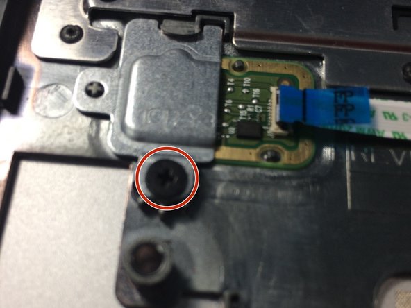

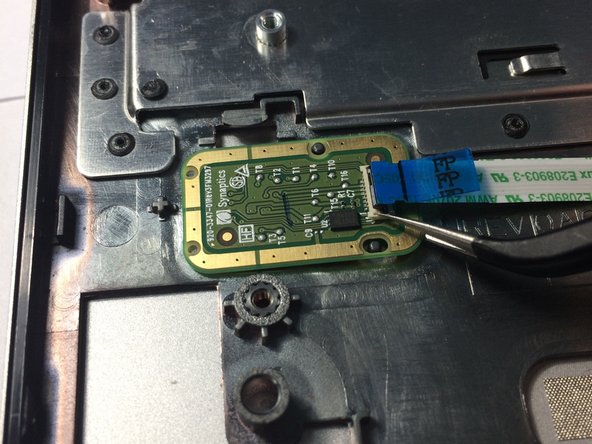

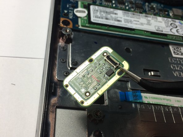

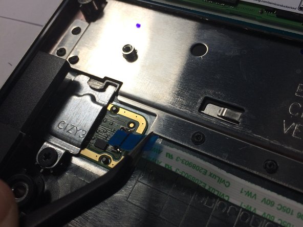

  8. Lenovo Yoga 720 Fingerprint Reader Replacement, Fingerprint Reader: crwdns2935265:08crwdnd2935265:01crwdnd2935265:03crwdne2935265:0 Lenovo Yoga 720 Fingerprint Reader Replacement, Fingerprint Reader: crwdns2935265:08crwdnd2935265:02crwdnd2935265:03crwdne2935265:0 Lenovo Yoga 720 Fingerprint Reader Replacement, Fingerprint Reader: crwdns2935265:08crwdnd2935265:03crwdnd2935265:03crwdne2935265:0
    • Using a spudger, lift up on the black connector of the ZIF socket on the end of the ribbon cable connecting to the fingerprint reader.
    • Be sure to make sure your pulling up the tab, not the socket! if you pull the socket you will damage the motherboard. You can check how to disconnect the cable using this guide.
    • Disconnect the cable from the socket.
    • Remove 1 JIS1 screw securing the bracket in place.
  9. Lenovo Yoga 720 Fingerprint Reader Replacement: crwdns2935265:09crwdnd2935265:01crwdnd2935265:03crwdne2935265:0 Lenovo Yoga 720 Fingerprint Reader Replacement: crwdns2935265:09crwdnd2935265:02crwdnd2935265:03crwdne2935265:0 Lenovo Yoga 720 Fingerprint Reader Replacement: crwdns2935265:09crwdnd2935265:03crwdnd2935265:03crwdne2935265:0
    • Remove the bracket,
    • Remove the fingerprint reader.
