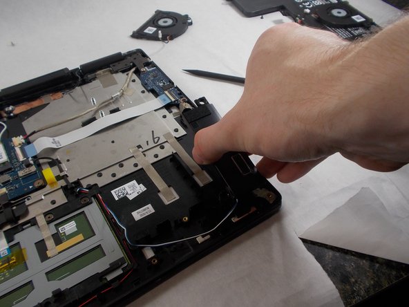

    • Remove the four 2 mm screws from the battery using a Phillips #0 screwdriver.
  2. Lenovo Yoga 710-15ISK Speaker Replacement: crwdns2935265:02crwdnd2935265:01crwdnd2935265:01crwdne2935265:0
    • Remove the connector between the battery and the motherboard by gently pulling the black plastic-coated part of the wires.
  3. Lenovo Yoga 710-15ISK Speaker Replacement: crwdns2935265:03crwdnd2935265:01crwdnd2935265:01crwdne2935265:0
    • Remove the battery from the laptop.
  4. Lenovo Yoga 710-15ISK Speaker Replacement, Speaker: crwdns2935265:04crwdnd2935265:01crwdnd2935265:01crwdne2935265:0
    • Disconnect the speaker wires from the motherboard by gently pulling the white connector from its port.
  5. Lenovo Yoga 710-15ISK Speaker Replacement: crwdns2935265:05crwdnd2935265:01crwdnd2935265:02crwdne2935265:0 Lenovo Yoga 710-15ISK Speaker Replacement: crwdns2935265:05crwdnd2935265:02crwdnd2935265:02crwdne2935265:0
    • Unwind the wires from the plastic hooks lining the case.
    • Lift out the speakers to remove them from the laptop.
