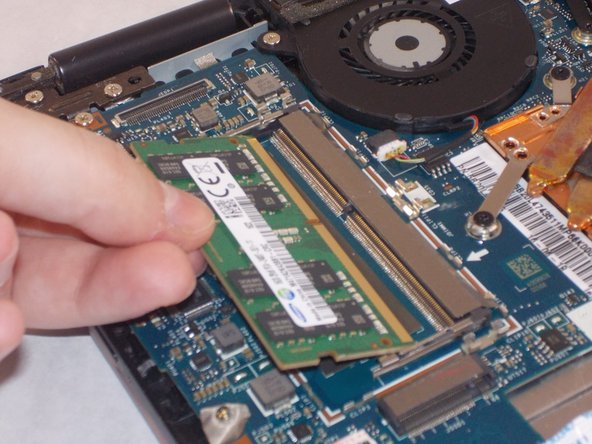

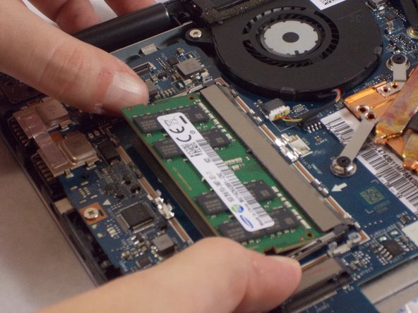

  4. Lenovo Yoga 710-15ISK RAM Replacement: crwdns2935265:04crwdnd2935265:01crwdnd2935265:03crwdne2935265:0 Lenovo Yoga 710-15ISK RAM Replacement: crwdns2935265:04crwdnd2935265:02crwdnd2935265:03crwdne2935265:0 Lenovo Yoga 710-15ISK RAM Replacement: crwdns2935265:04crwdnd2935265:03crwdnd2935265:03crwdne2935265:0
    • Use your fingers to take apart the clips holding the RAM in place.
    • Carefully slide the RAM out of its slot.
Congratulations! You’ve successfully replaced the RAM in your Lenovo Yoga 710-15ISK. Enjoy the enhanced performance, whether for multitasking or demanding applications. If you encounter issues, refer to your laptop’s manual or seek professional assistance.
