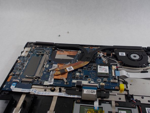

  12. Lenovo Yoga 710-15ISK Motherboard Replacement, Motherboard: crwdns2935265:012crwdnd2935265:01crwdnd2935265:01crwdne2935265:0
    • Remove seven 2 mm screws from the motherboard using a Phillips #0 screwdriver.
  13. Lenovo Yoga 710-15ISK Motherboard Replacement: crwdns2935265:013crwdnd2935265:01crwdnd2935265:03crwdne2935265:0 Lenovo Yoga 710-15ISK Motherboard Replacement: crwdns2935265:013crwdnd2935265:02crwdnd2935265:03crwdne2935265:0 Lenovo Yoga 710-15ISK Motherboard Replacement: crwdns2935265:013crwdnd2935265:03crwdnd2935265:03crwdne2935265:0

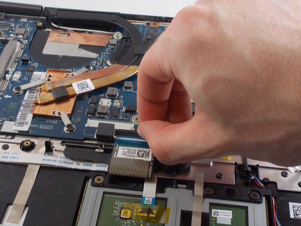

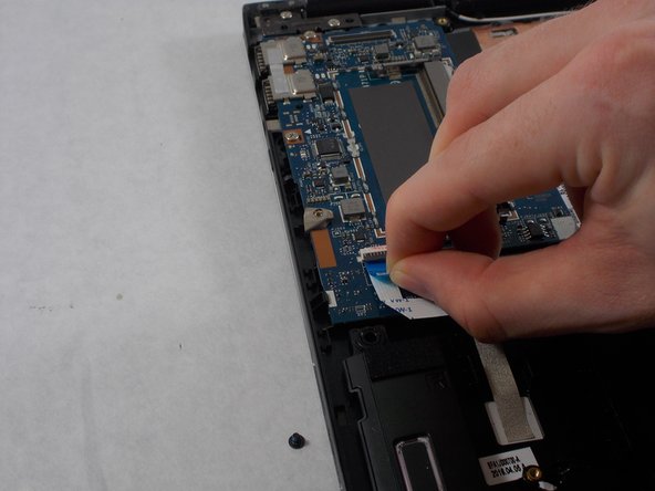

    • Unplug four cables attached to the motherboard.
    • For the flat ribbon wires, lift the black tabs holding them in place before removing them.
  14. Lenovo Yoga 710-15ISK Motherboard Replacement: crwdns2935265:014crwdnd2935265:01crwdnd2935265:01crwdne2935265:0
    • Carefully lift out the motherboard to remove it from the laptop.
