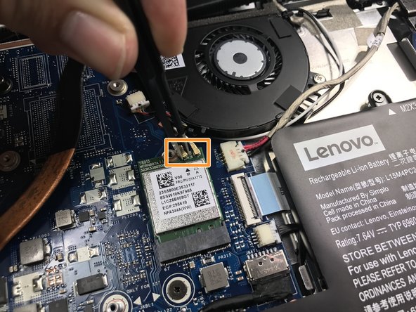

    • Peel off the black tape covering the top of the WiFi card.

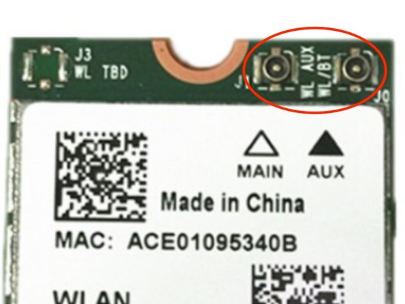

    • Remove the black and white antenna cable attached to the card by pulling them off using the precison tweezers.
    • BE CAREFUL! The antenna socket is VERY FRAGILE. If you use brute force, the antenna socket on board (female) will be pull out with the male connector.
    • If you disconnect the antenna cable properly, the socket will remain undamaged like fig.3
  4. Lenovo Yoga 710-14IKB Wi-Fi Card Replacement: crwdns2935265:04crwdnd2935265:01crwdnd2935265:01crwdne2935265:0
    • If you disconnect it with brute force, it will be damaged like that.

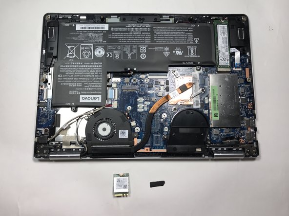

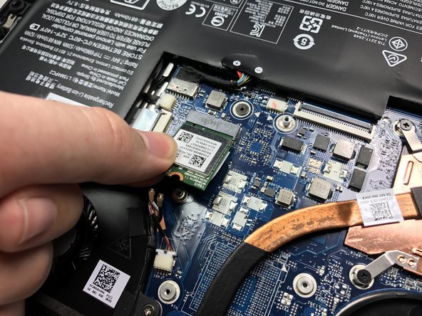

    • The WiFi Card should be unbound from the surface. Carefully remove the card from the laptop by puling away from the socket.
