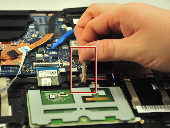

  7. Lenovo Yoga 710-14IKB Trackpad Replacement: crwdns2935265:07crwdnd2935265:01crwdnd2935265:02crwdne2935265:0 Lenovo Yoga 710-14IKB Trackpad Replacement: crwdns2935265:07crwdnd2935265:02crwdnd2935265:02crwdne2935265:0
    • Grip the blue tab and pull out.
    • Careful to not pull too hard, there is a chance of damaging the tab.
