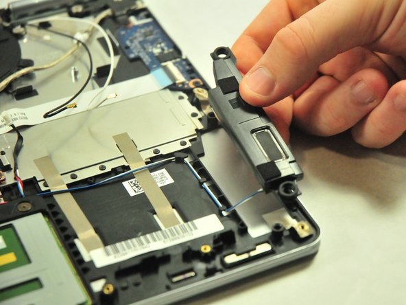

  6. Lenovo Yoga 710-14IKB Speaker Replacement, Speaker: crwdns2935265:06crwdnd2935265:01crwdnd2935265:01crwdne2935265:0
    • Locate the speaker's plug and disconnect it.
    • Follow the wires connected to the plug to locate the speakers. The left speaker will have red wires, and the right speaker will have blue wires.
  7. Lenovo Yoga 710-14IKB Speaker Replacement: crwdns2935265:07crwdnd2935265:01crwdnd2935265:02crwdne2935265:0 Lenovo Yoga 710-14IKB Speaker Replacement: crwdns2935265:07crwdnd2935265:02crwdnd2935265:02crwdne2935265:0
    • Untangle the wires from the plastic hinges of the case to properly lift the speakers out.
